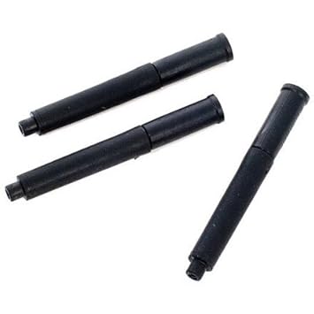

Cheap alternative

and some sort of link to them FH?
SP41 in bulk for me, only run full length cables and just use cheap and cheerful ferrules.. still interested in those sealed(?) ends FH..

z1ppy - Member
On Singletrack Bikes site, Shimano SP40 with rubber shield, I think?
