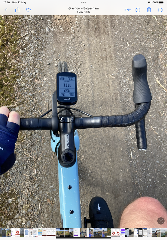

MTB Mount and 830 on my ‘MTB’ gravel bike right now :
[url= https://i.postimg.cc/xTRz5ZhH/IMG-1462.jp g" target="_blank">https://i.postimg.cc/xTRz5ZhH/IMG-1462.jp g"/> [/img][/url]
and on the out front mount on my more road orientated gravel bike:
[url= https://i.postimg.cc/hP8cFW1y/IMG-0757.pn g" target="_blank">https://i.postimg.cc/hP8cFW1y/IMG-0757.pn g"/> [/img][/url]
Posted : 22/05/2023 6:39 pm

Thanks for the pics. Looks like if you reversed it and also rotated the mounting with the hinge positioned on the leading edge of the bars you could get it lower and out front.

I guess you could, though probs not much different to the regular out front one - they come in 2 lengths, standard as above and extended for the 1040 size units
