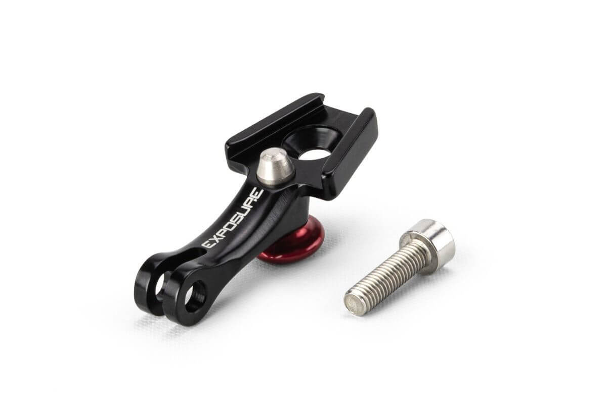

I've got a newer Garmin out front mount with the Varia (male) bit underneath (designed to use with Varia lights or the Garmin battery pack). Came free with my Garmin 530.
This:
https://www.sigmasports.com/item/Garmin/Quarter-turn-to-Friction-Flange-Mount-Adapter/H4JA
And this:
https://www.condorcycles.com/products/exposure-lights-3-prong-action-camera-mount-to-exposure-cleat
Make a neat, QR solution.
