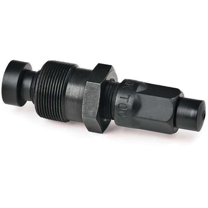

Posts: 520
If this bearing is mount is thread like on my DPX2 then one half on an ISIS crank removal tool has the same thread. Thats what I use. Thread it in  and  tap it out with a soft faced hammer.like this
https://www.sprocketscycles.com/products/park-tool-cwp-7-crank-wrench-puller?variant=35816488730777&country=GB&currency=GBP&utm_medium=product_sync&utm_source=google&utm_content=sag_organic&utm_campaign=sag_organic&gad_source=1&gclid=Cj0KCQiAqL28BhCrARIsACYJvkc1u_y04Retr55CJQ0R1hWE1BLdlKBd4ZfRS56U3zXprXml0bjyMC4aAipwEALw_wcB
