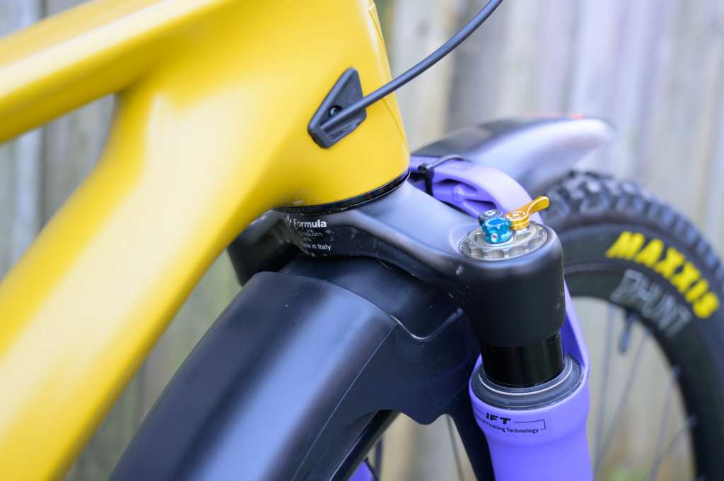

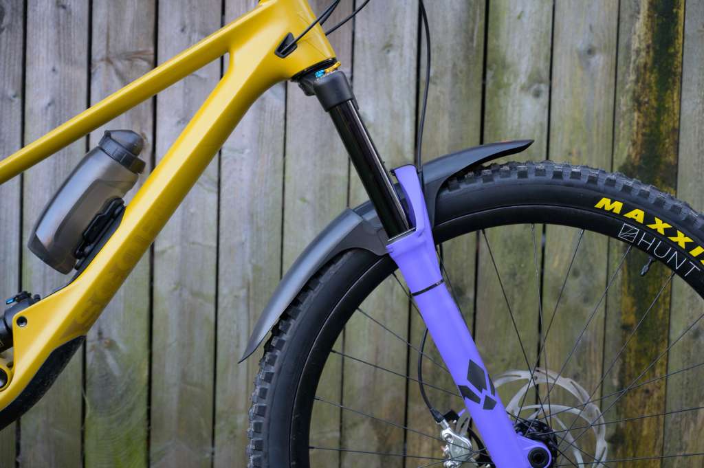

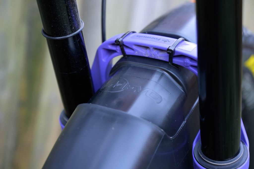

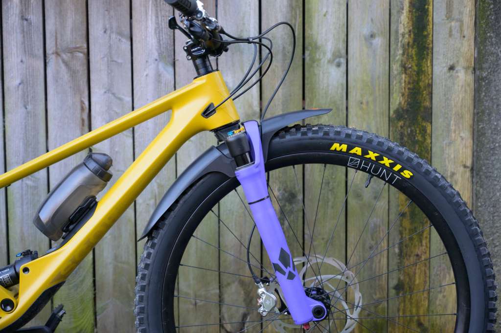

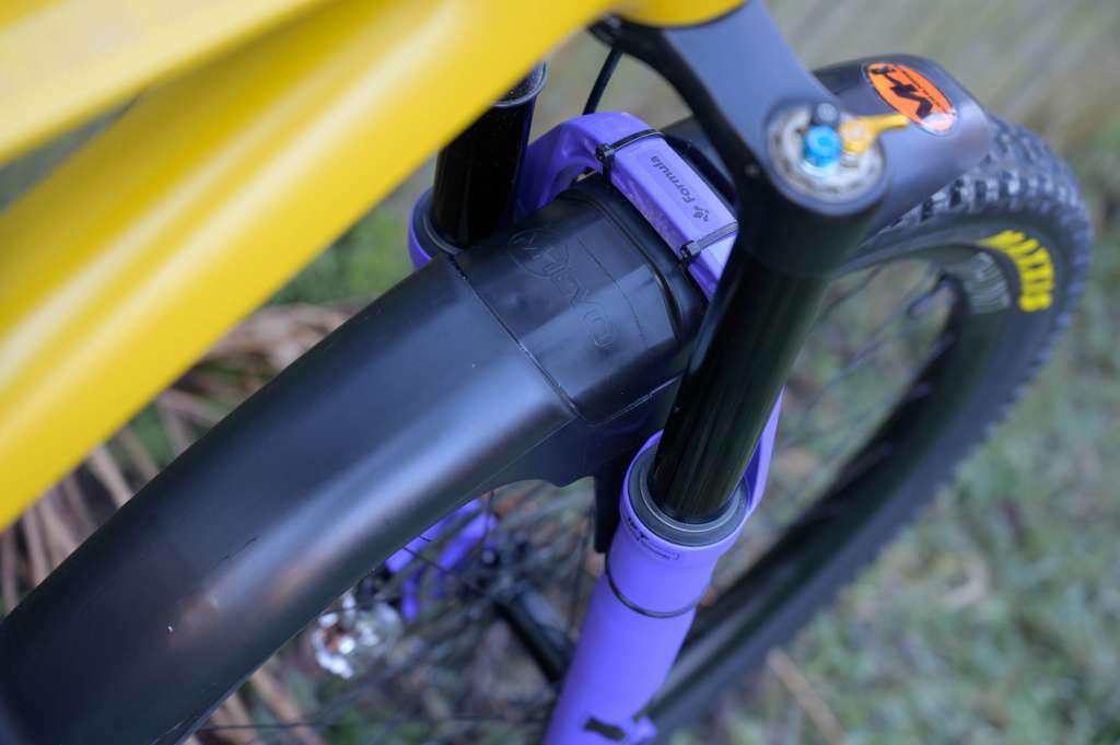

Can confirm that the Mudhugger Evo fits fine and doesn't push the mudguard into the tyre under full compression.

Excellent, thanks. I did read somewhere that stanchion would be showing even at full travel, as seen in your photos.
Nice colour match too!

Cheers, I think that's a better and nicer looking one than the Mudhuggers, only swapped due to the clearance issue on my Pike.
I'm surprised it works though (if you do ever use the last 5-10mm of travel) based on how close it looks on Sim's photo. That recess is a good 8mm deep at the back, and maybe 5mm at the front.
