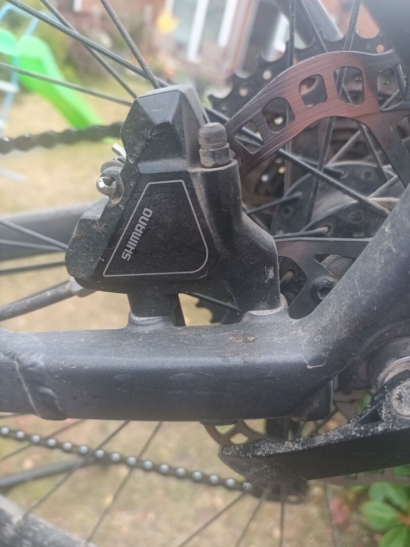

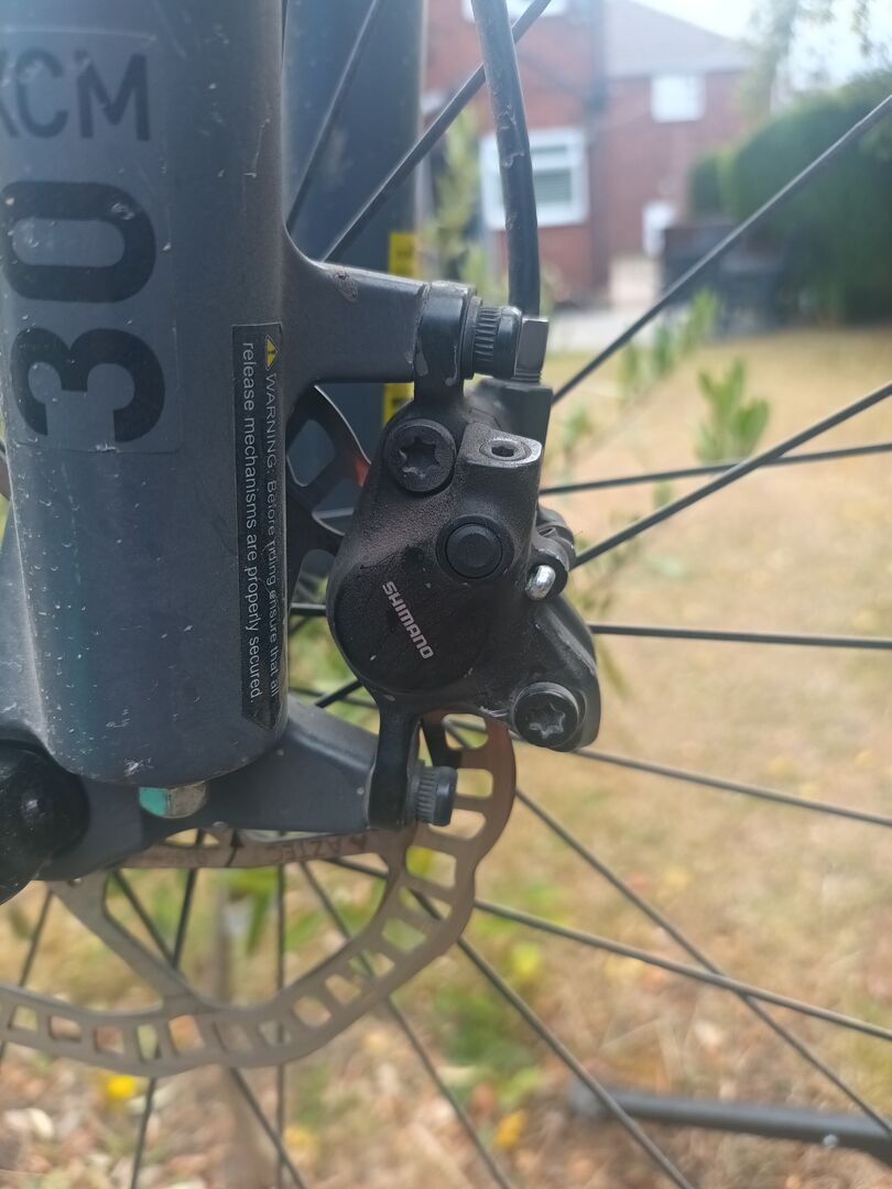

fitting a 203mm to my front end and a 180mm to the rear.
i need help to source the correct mounts.
i think the front may be a post to post mount ??
no idea at all what the rear is.     any help greatly apprciated.

Front is post mount
Rear is flat mount.
I’ve not seen a 180mm adapter for flat mount though.

Posts: 31778
What size is the current rear disk? You'll need a different adaptor depending on whether it's a 140 or 160 rear FM. Note that you can't use that front FM adaptor above on the rear.

Posts: 31778
If you have a 160mm rotor there... this adaptor will allow you to fit 180mm...

rear disc in 160.   want to change to 180
front is 160. want to go to 203.

Posts: 31778
Shimano SM-MA-F203PP for the front.
Shimano SM-MA-R160D/D for the rear.
