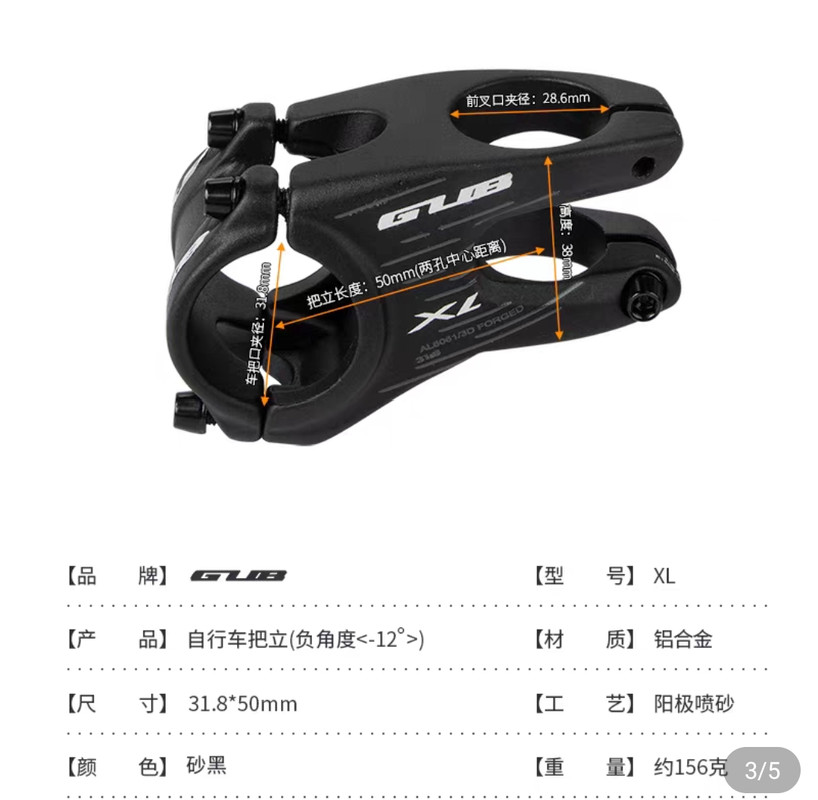

I've seen a number of "drop" stems with 12deg angles marketed for, I guess, shorter rider than me who get new 29" modern bikes and find their bars too high so need them dropping to get their preferred riding position.
[url= https://i.postimg.cc/Xqh07gJt/Screenshot-2021-12-11-13-40-59-94-090d9ae461b065ca11c329abb9cd0d70.jp g" target="_blank">https://i.postimg.cc/Xqh07gJt/Screenshot-2021-12-11-13-40-59-94-090d9ae461b065ca11c329abb9cd0d70.jp g"/> [/img][/url]
[url= https://i.postimg.cc/QCjqKLBT/Screenshot-2021-12-11-13-50-22-27-090d9ae461b065ca11c329abb9cd0d70.jp g" target="_blank">https://i.postimg.cc/QCjqKLBT/Screenshot-2021-12-11-13-50-22-27-090d9ae461b065ca11c329abb9cd0d70.jp g"/> [/img][/url]
[url= https://i.postimg.cc/Nj2RMGNn/Screenshot-2021-12-11-13-52-05-19-090d9ae461b065ca11c329abb9cd0d70.jp g" target="_blank">https://i.postimg.cc/Nj2RMGNn/Screenshot-2021-12-11-13-52-05-19-090d9ae461b065ca11c329abb9cd0d70.jp g"/> [/img][/url]
Personally, being overly tall, I find most cockpits too low and have to custom it. Getting strong, stiff riser bars is a major problem, especially where I am located. I'd say pretty much all 50mm risers are now out of stock due to manufacturing/supply chain issues. I keep ordering them and they don't turn up, then they claim out of stock/damaged stock)
I can source the odd 40mm riser which may not work as is, but then it's down to 30/35mm.
Looking at these stems, I'm wondering how safe they'd be if I flipped them to be able to use a 30mm riser bar and be happy with it?
Is it about where the join between stem and faceplate is? I use a torque wrench so pressure should be equal all around.
Or is it simply down to design and testing not intending the stem to be used upside down?

My only reservation on all the above is that you seem to be scraping the eBay barrel for examples.
Some of those designs look awful and their specs are solely in Chinese. Spidey sense is tingling.
with a reputable brand I'd have no issue doing it.
Example number 3 ...... I'd struggle to fit to my bike even right ways up even with a brand name on it..... As an eBay special I'd scroll on by.
Posted : 11/12/2021 9:48 am
Posts: 3384
Example number 3 …… I’d struggle to fit to my bike even right ways up even with a brand name on it….. As an eBay special I’d scroll on by.
It's a Syntace, probably one of if not 'the' best made stems out there.
Posted : 11/12/2021 9:53 am

I'm a happy Syntace owner, but that looks like a Syntace but has no Syntace logo. I'd be wary.

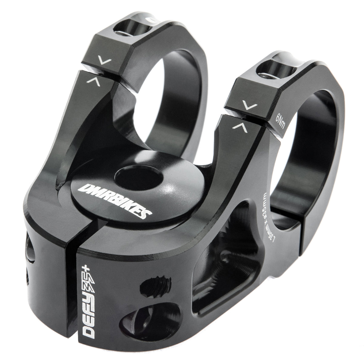

What about a dmr defy?
It looks like the stems you have pictured up there but the other way up
https://www.dmrbikes.com/Catalogue/Components/Stems/Defy35

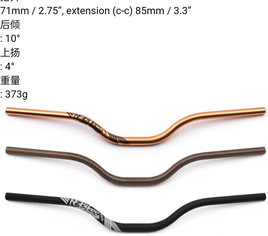

I fitted a shorter rise bar, went out between the rains and did my lower back in.
I think with fitting a longer fork I am bringing the grips too close to myself.
I "may" need an 80-90mm drop stem, correct way up (down! 😂). The website with the measurements didn't really do grip position. Perhaps the sweep of my bars has something to do with it too. and a really high rise bar to stretch the reach out. The Marin SQ does have a really short reach and getting a longer fork reduces it further obviously, particulary since I'm lanky.
There's a seller out here with one pair of brown coloured NS bikes Proof 25.4mm HI bars (85mm at grips) for £61. The sweep seems excessive though at 10deg.
