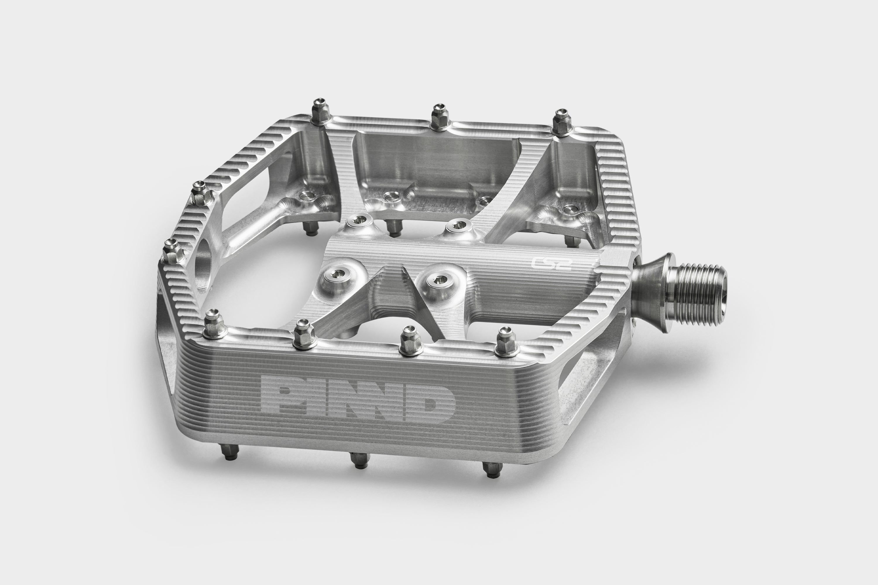

Shimanos are quick and easy to adjust the bearing preload on.
Pinnd use bearings throughout and have a lovely concave profile.

 ojom
Posts: 177
Thanks @sillyoldman 👍 - we just released SS axle versions this week too.
https://www.pinnd.co.uk/products/cs2-pedal-black
Transparency - I work with PINND.
Posted : 18/03/2023 3:37 pm
