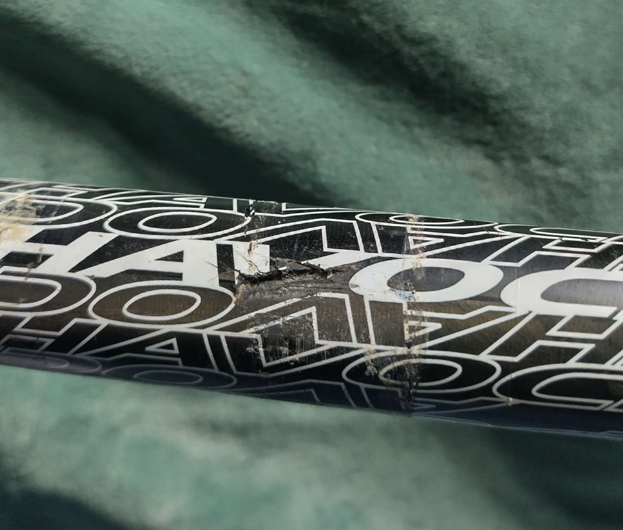

I'd use the old bars but they're 750 instead of 780 and not sure I want to go back to 750 especially with a shorter stem. Plus they're damaged anyway
Is that the ones in the picture with the hole in? I'm not overly precious about small amounts of damage to MTB components, but no way would I use those! Only fit for the bin.
Posted : 23/08/2025 2:12 pm
Posts: 342
Yeah, they're the old bars. Stopped using them because of that. It's surface crush damage from a clamp.
Agree, definitely bin.
Or I could cut them down and sell as 400mm bars 😄
