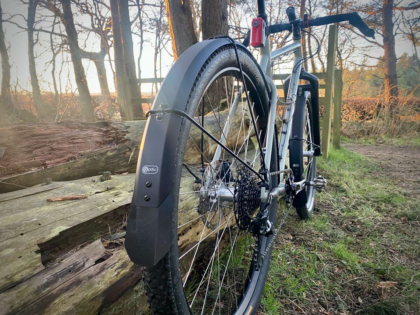

Posts: 4120
Posted by: el_boufador
Hmm, looking at the profile of the fork arch I really doubt whether the 56mm sks edge will fit under there. Are they a very squared off as they bend around?
They are indeed a very squared profile - they'd be improved by being more shaped to more closely follow a curved tyre profile IME. Saying that, they're by far the best of the SKS/cheaper mudguards I've used offroad: very little rattle, even at the MTB-y end of gravel riding. 56mm Edge AL worked well with the Clement X’Plor MSO 700x50 I used, which sized up around 53mm wide on 25mm internal rims.
Also, already mentioned above are PDW Full Metal Fenders. I wanted wider tyres on my Cascade so replaced the Edge AL 56s with 29x2.5 PDWs with 29x2.2 RaceKings. Pricy but solid and similar lack of rattle to the Edge ALs. Slightly rounder profile (the flat top isn't as wide as the SKS, with the sides/wings being longer) so might work better for tighter clearance frames.
Posted : 03/11/2025 9:33 am
