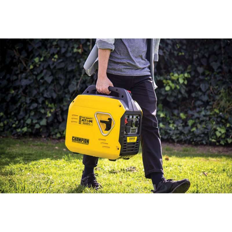

Runs on petrol or LPG if you have that in the van
92001i-eu-lchampioninverterelverk2200wthemightyatom-miljo-88276

Posts: 15222
100% not getting a diesel genny was next to someone who had one in inners carpark a while ago and its the most antisocial thing ever bith noisy and loads of fumes
Well, it's not diesel and they do one that runs about 50dB
But yeah, get you
