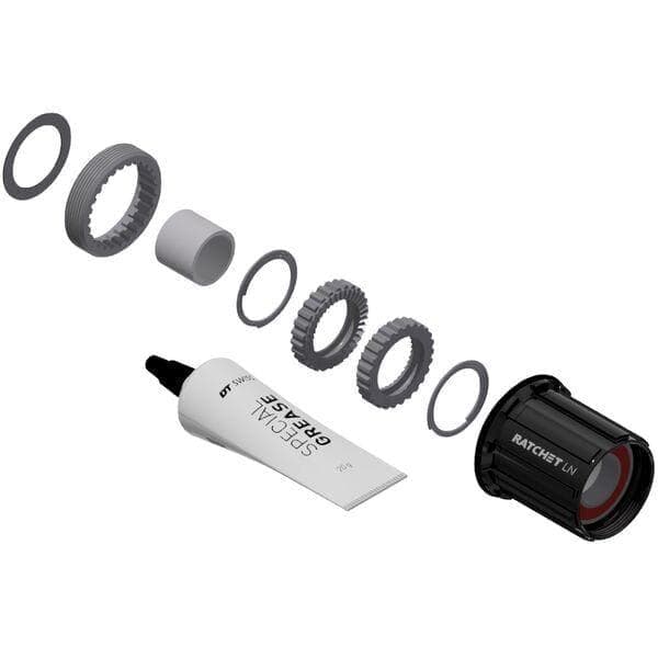

Is it something like this?
https://www.bikeparts.co.uk/products/dt-swiss-ratchet-ln-conversion-kit-for-3-pawl-hubs-mtb-36-tooth-shimano-hg-aluminium
Posted : 09/09/2023 2:27 pm
Posts: 8273
Yeap that's the upgrade kit. Tools are on top! DT branded tools are expensive but there are copy's available for a lot less.
