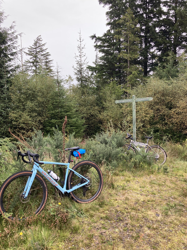

I have one with and one without, horses for courses, love them both
[url= https://i.postimg.cc/sXm8rm4z/IMG-1849.jp g" target="_blank">https://i.postimg.cc/sXm8rm4z/IMG-1849.jp g"/> [/img][/url]
[url= https://i.postimg.cc/B64ykkDN/IMG-2225.jp g" target="_blank">https://i.postimg.cc/B64ykkDN/IMG-2225.jp g"/> [/img][/url]
