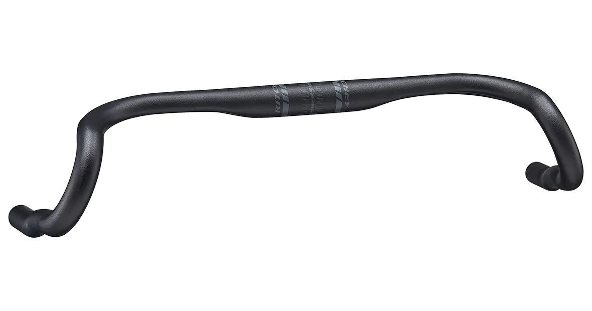

If you are looking for new bars, these have a nice shape, but drop bars are a bit like saddles...
https://eu.ritcheylogic.com/eu_en/bike/handlebars/comp-venturemax-handlebar

It’s my first time fitting drops. I’ve got Ritchey Beacons after some great advice on here last week.
I’ve given these a quick spin, and they feel good. Does this seem like an ok set-up?
I’m aware that the reach of the levers is very tight. It was the only way I could reach them with the old bars. I’ll loosen them off a bit when I’m sure I have a good position.
PS comments about state of garden, dirtiness of chain, etc all considered.
