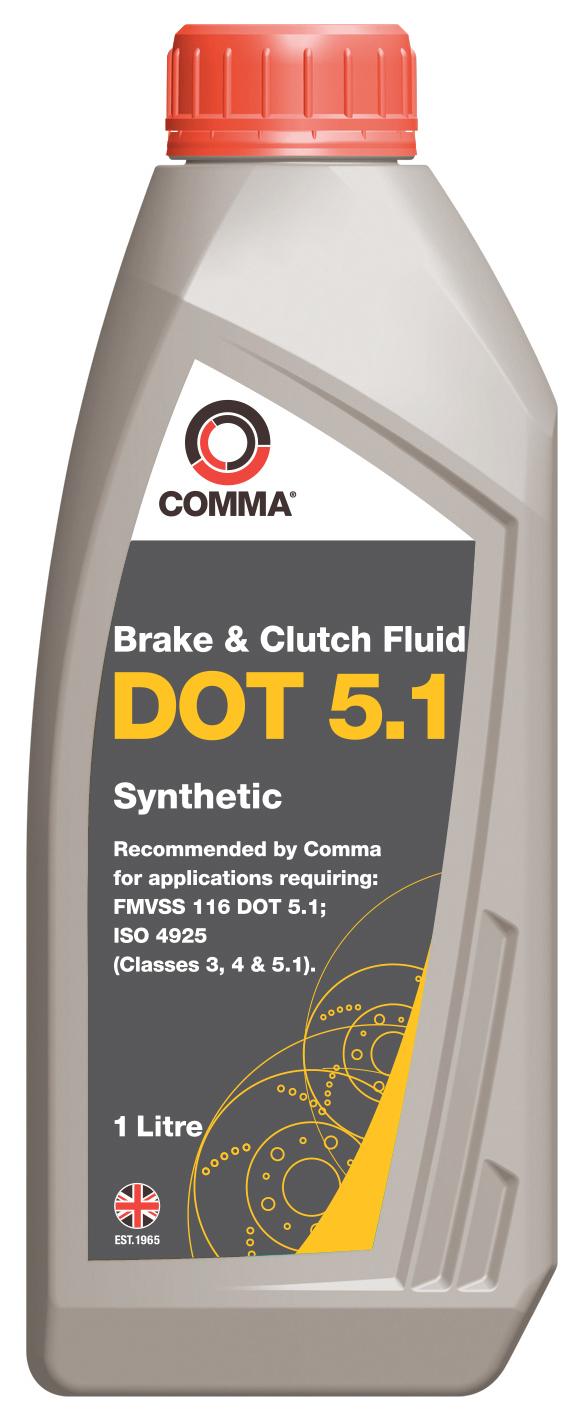

Posts: 6820
Confused I am. All the bottles of 5.1 that I have bought and I look for this, have "Synthetic" written on them....
I'm not wanting to start a Pedant War, but whats going on ?
[img] http://i1.adis.ws/i/washford/124473?$imageMainRetina$ [/img]
Posted : 11/03/2016 3:50 pm
Posts: 3834
Synthetic doesn't mean silicone. DOT4 and 5.1 are made from poly glycol compounds apparently.
