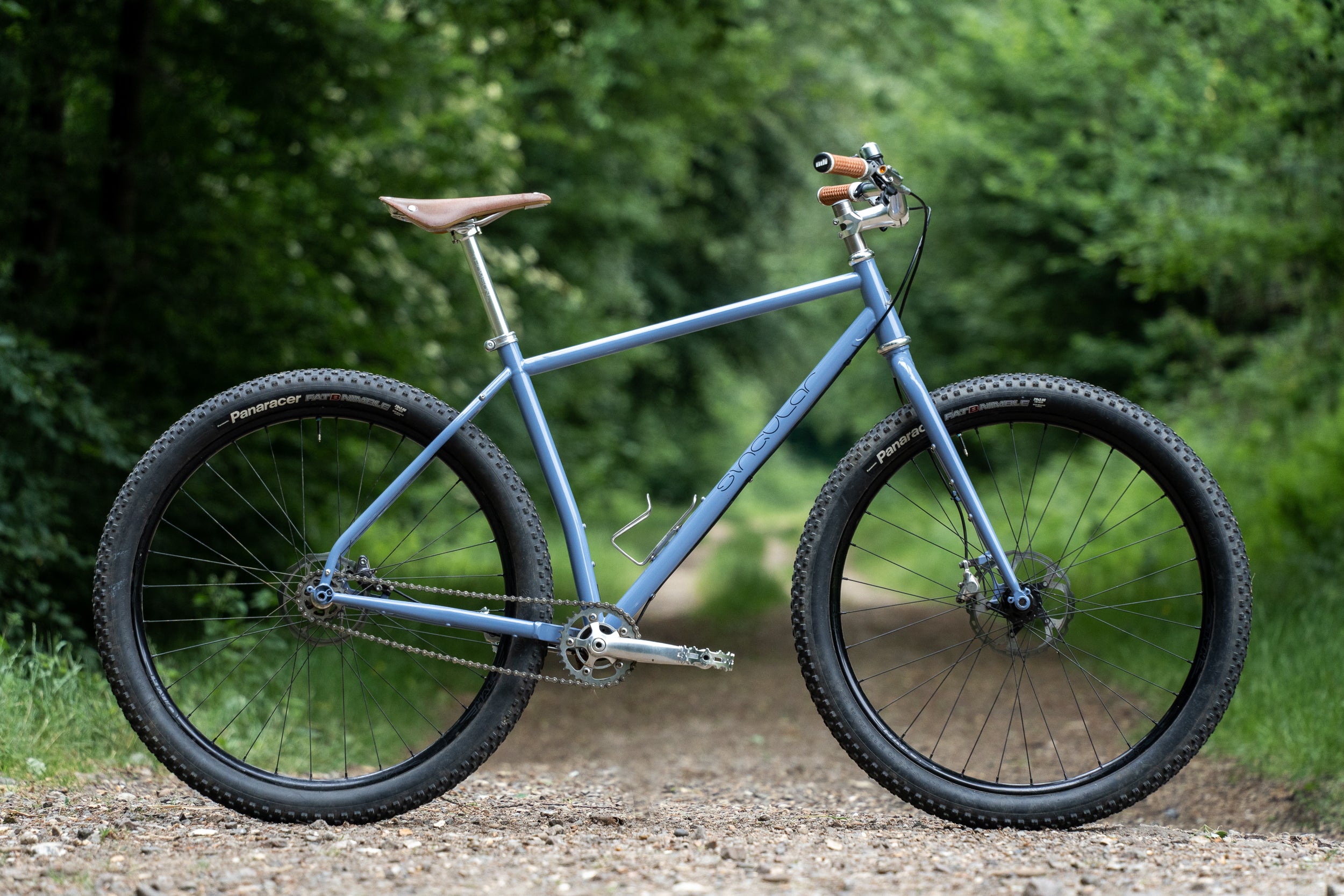

After finding a crack in my Titus Mutsu ti frame I’ve been considering what to replace it with*.
If you were looking for a bike/frame fitting the following criteria, which would you consider?
Steel
Rigid
29er/700c
Flat bars (not drops)
Boost spacing ideally (to fit existing wheelset)
Mounts for full length mudguards
Clearance for 700x50 plus mudguards 36-38t chainring clearance (1x setup)
I’ve got a 490mm a-c eXotic monocoque fork to reuse so geometry that’d accept that would be great, but not a deal breaker if it comes with its own decent fork.
Current frontrunner is a Kona Unit as the geometry/sizing ticks my boxes – I get on well with a decent reach (GeoMetron owner) so would be looking at XL sizing. A Surly KM is a good bit shorter reach with a 2deg slacker HT angle, and from what I’ve read elsewhere is a fair bit heavier. My worry is that something like a Surly KM or Kona Unit is too ‘adventure bikey’ and the frame might be overkill/overbuilt for my needs, i.e. might not be as comfy as a bike could be (I won’t be using it for carrying heavy loads – other than myself…). I’m probably wrong though?
The Mutsu was – I believe – a Planet X interpretation of the Sonder Broken Road (hence me now christening mine as a Titus Broken Mutsu) with near-identical geometry figures. It was nearly perfect for my needs so I’m looking for something close to that but steel.
What should I be considering?
Thanks.

One more then. Sonder Camino. Available in flat or flared drop bar.
Posted : 14/06/2023 3:33 pm
a11y reacted
Posts: 1679
If you are worried about the price of the Cotic, how about the Spa Rove with an angleset? Geometry would end up very similar (I think)
Posted : 14/06/2023 3:45 pm
a11y reacted
 a11y
Posts: 4094
I'd considered the Camino already. Ruled it out due to material but the geometry isn't that far away from the Cascade (-15mm reach, -5mm chainstays, -30mm wheelbase). I'm looking at it again as the GRX1 build is great value - I've a dropper I could swap in but would need something like the PNW lever.
It would indeed: -2deg headset would give the same 69deg HA, within 0.7deg STA, main difference 25mm shorter reach and 10mm shorter ETT. Spa appear to be marketing the Rove as flat bar but the geometry's close to the Cascade, so no reason it wouldn't work with drops. With the exception of shifter/brake levers and a rear mech, I could use everything from my broken Titus. But I could do the same with a Cascade frameset if I used post-to-flatmount adaptors.
Possibly further confused about what to do now, but in a good way. Thanks @legometeorology and @mandog.
Posted : 14/06/2023 6:11 pm
 a11y
Posts: 4094
Update: Cascade frame ordered 🙂
