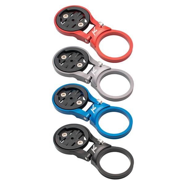

You could use a garmin headset spacer mount like the K-edge as it is already hinged. Hopefully you can find a cheaper version

Thanks for those suggestions ...looks a possibility but as you say ..probably too weak for the job
the other issue is that the spacer really needs to be locking otherwise it may still allow the steerer to rotate .
