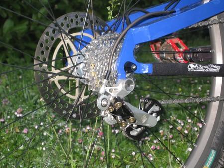

There was a French company, EGS, who tried to market an 'Upcage' Derailleur back in the late-90s, but that actually sat horizontally, parallel with the chain stay.
https://www.disraeligears.co.uk/site/egs_up_cage_derailleur.html

Shame it didn't work out,that EGS mech is a thing of beauty

I saw the Upcage in the flesh at Bike99 in the NEC. I suspect the real problem was that it was sold as part of a system that used a very clever grip shift to sequentially shift both front and rear mechs in the appropriate order to get the smallest steps in ratio. I imagine that it must have been (a) very difficult to adjust, (b) quite sensitive to mud throwing it out of sync, (c) quite delicate. It was certainly eye-wateringly expensive. 😮

Shimano have a patent out on a design very similar to the upcage.
