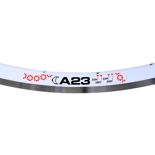

whats does everyone think to this as a CX wheel build?
Velocity A23 rims - WHITE
Hubs - Hope pro 2 evos - RED 32H
Nipples - red aluminium
Spokes - Black DT revolution.
Weight comes in at 1700g, which seems a lot heftier than my american classic 26" wheels, but they are only 26". is this not too bad a weight for a cx wheelset? Quite keen on the white rims and also being able to run higher pressures with road tyres so 29er mtb rims are probably out.

I think it's a silly waste of money. CX wheels get a fair bit of hammer, so you don't spend loads on them, or use alu nipples. It's for riding, not showing off in the car park.

He's quite possibly right though but what you're talking about it a pretty solid setup so I wouldn't worry too much. White rims though? 😯

normal black anodised rims will be lighter than painted white 🙂
alloy nipples have no place on wheels which may need tweaking (i.e. cx!) IMO .

I'd avoid alu nipples, seen too many seized.
Open pros any lighter?

Nice buid, seems heavy though, [url= http://www.stradawheels.co.uk/shop/velocity-major-tom-cyclo-cross-wheelset/ ]Strada do a nice set here[/url]

A pair of Mavic Aksiums weigh in at 1735gm and can be had for £140, how much is your build gonna cost?
Ahh discs = more £ more Gm and not needed if FRO.

Interesting - every pair of wheels I've had alloy nips on have seized nipples within a year. Shimano RS10's, Scott OEM supplied with bike - Scott branded hubs, Mavix XC717 rims, rev. spokes, and a pair of hand builts years ago.
I'd be inclined to go with Mavic Open Pro or for very light weight, Stans Alpha 340.
