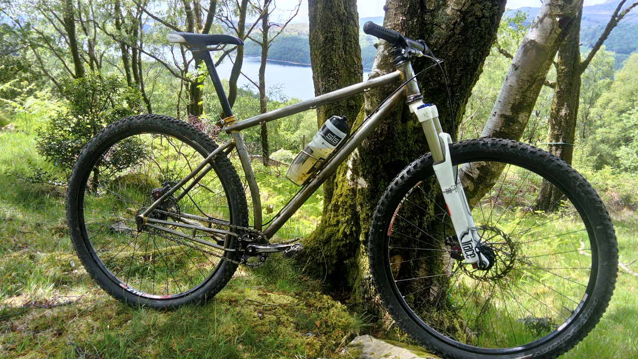

Posts: 7941
SSStu's design is virtually identical to what I'd go for (Also 6ft). As it is I ride a production Pole Taival that is quite similar.
The Taival has loads of subtle tube manipulation all over it, as well as the butting, does Marino manipulate their tubing too?
I'd go for a taller stack, slightly longer reach and slightly less slack fork, but we're well into personsl preferences.

Posts: 3679
You'll get more comfort / flex by using a 27.2mm seatpost than any frame tube manipulation. Similarly the 73 seat angle will help a little compared to current steep fashions.
I use a curved seat tube for tyre clearance as I run short chainstays (410 ish). A by-product of this is that the 67 deg top part of the tube again adds a bit more flex from seatpost bending (effective sta is 72deg).
[url= https://i.postimg.cc/Y2vyV7Rv/DSC-0629.jp g" target="_blank">https://i.postimg.cc/Y2vyV7Rv/DSC-0629.jp g"/> [/img][/url]

That looks good - I wouldn’t mind something that has that line from the top tube down into the seat stays - just without that seat tube brace. Mine wouldn’t be so slack / wouldn’t be getting ridden so hard so if there could be a more subtle brace there that would work.
I’ve dropped Waltly an email too to get a ball park cost for one of their frames but I’m expecting it to be too expensive.
Someone suggested Curtis - their 853 frame for £1150 with custom geometry at no extra cost looks good but a fair chunk over budget unfortunately.

Looks like a powered up TIG plant in the background of Stu's photo so probably finished by now (or at least tacked together and on the welding bench).
Paint over there or in UK?
That's something that I asked specifically for.
No paint, going for a raw finish with clearcoat.
That's being done over there.
