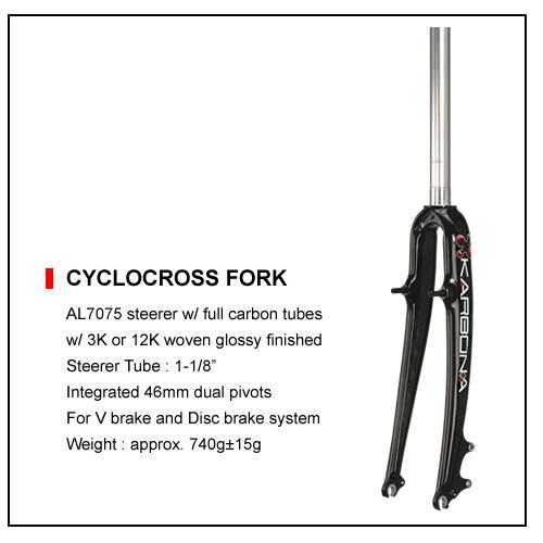

actually, 405mm could be a bit long.
this is what I have right now, and they're pretty good, but overall my bike is a bit heavy since I disc'd it up.
Posted : 13/09/2012 2:16 pm

Too long/too heavy?
