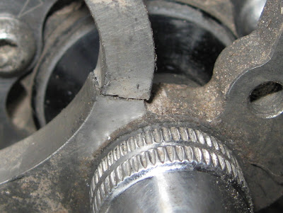

So without going into details my Titanium frame has cracked around the seat tube/top tube weld.

I have attached a pic. Can it be repaired?

There is 14cm of Thomson post in the frame. Warranty says 10cm minimum.
I'm 6'1" on a large frame.

I have seen similar cracks repaired. and recrack. to be repaired with a sleeve.

Doubtful that can be repaired satisfactorily - as the crack that starts at the TT/ST junction weld extends vertically down the side of the TT away from the weld.
I'd be VERY wary of riding a frame like that after a repair - it looks like an accident waiting to happen.

Just having a quick look at the picture, I would be curious to know what the inside of the top tube looks like. There may have been insufficient purge / shield gas (argon) in the toptube during welding to prevent the tube absorbing oxygen or nitrogen from the air. In which case there will be visible discolouration of the inside surface of the tube, meaning that it is impossible to do an effective repair.
Once titanium (a weld or parent-metal) absorbs too much oxygen or nitrogen (although commercially pure titanium can rely on tiny amounts of oxygen for some improvement in strength) then it is likely to crack.

In a repair scenario the TT would need to be replaced, a blob over the top of the crack would be a bodge job and I definitely wouldnt feel comfortable riding it with my 12 stone let alone your 14. Getting the TT replaced will probably cost Cotic more than it would be just to hook you up with a new frame.

For me working in an industry that uses fabricated ti and alloy regularly that is not a good repairable option. If the crack was around the weld and only on the weld, then it would be less serious. In this case it looks like the tube itself has failed. The crack has then run around the tube . Butt welding tubes that are under tension is not ideal. Not a good repair.
If it was a last gasp attempt to fix or bin perhaps you could re-weld then add a a gusset between seat tube / top tube to support the seat tube and help spread the load between the tube junction.
