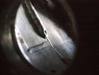

BB[img] [/img]
Posted : 22/05/2021 10:09 am
Posts: 186
This is a day of days !!!
Posted : 22/05/2021 10:10 am
Posts: 2091
Right - what you’re seeing in that photo is weld penetration right through to the inside of the shell from the external weld. To me, that looks about perfect. There is no way that is going to be the source of any creaking and, to be honest, I can’t understand what LV are on about when they say “they’ll repair it”?
Even if they can prep and weld that small area that you can see, then that will both damage the anodising and, more significantly, compromise the heat treatment in that area.
Having studied (briefly) the outside of my 301 BB shell there is no way that it would be possible to fully weld it internally anyway - especially the area that forms the suspension pivot - maybe the most highly-stressed area?. There’d be no means of getting a tig torch into there, never mind manipulating the filler rod.
The BB shell is probably welded as a sub-assembly before being incorporated into the main frame assy and so not only will it be welded around all its periphery but then a considerable part of it will, in effect, be reinforced by the down tube and seat tube being welded onto it and bridging the joint line.
I’d not worry about the integrity of the frame and would look elsewhere for the source of creaking. I will, however, strip mine as soon as I get a chance, have a skeet in there and take a photo or two, even if it proves me wrong.....

Is it just me or are those welds cracked?

 K
Posts: 892
Unless you can actually see a crack on the outside of that welded joint with thickness and the amount of weld penetration I would be pretty sure that it's not going to ever be an area of concern.
Posted : 22/05/2021 10:45 am
If you are looking at the line on the inside of the weld penetration then that is just where the back side of the material has deformed, the weld there does not require full penetration due to the thickness of the parts being joined therefore the parent metal is still going to be visible on the back.
Posted : 22/05/2021 10:53 am
Posts: 8210
That lump of weld, down to the right that's standing proud of the interior of the BB shell ... It's not rubbing on something like the crank axle or the inboard end of a BB cup as the frame/axle flexes is it?

I might carry on looking for the creak as it seems the weld is good
It seems Liteville disagree. I assume these are the same photos they saw?

Posts: 2091
As I said before, for the life of me I can’t see what Liteville think could be wrong and, apart from swapping the frame (which you’d think was pretty unlikely - brand new Mk15 anyone?) I can’t see what they’d do either.
That BB shell is a pretty hefty chunk of aluminium and we have evidence of weld penetration, because we can actually see it on the inside.

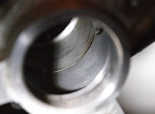

[url= https://i.postimg.cc/3RDSKKwK/5-F403548-ACEA-445-B-AFFF-274619-AF8-A39.jp g" target="_blank">https://i.postimg.cc/3RDSKKwK/5-F403548-ACEA-445-B-AFFF-274619-AF8-A39.jp g"/> [/img][/url]"
[url= https://i.postimg.cc/gjFMjfw3/72627-D4-B-3-C59-4-E67-B33-E-2104-E6226-CF2.jp g" target="_blank">https://i.postimg.cc/gjFMjfw3/72627-D4-B-3-C59-4-E67-B33-E-2104-E6226-CF2.jp g"/> [/img][/url]
Top image is looking forwards, bottom image rearwards.
No complete weld around the joint line (as expected) and what you see are little more than assembly tacks, given that there’s no prep.
The rear one is basically just an extended tack, done while there was still access before the down tube and seat tube were attached.

As far as LIteville’s response goes, I tend to agree with chiefgrooveguru (if only because we bass players have to stick together....) that it’s a standard customer service type reply.
There’s no way that they can change weld specs on an already completed and heat-treated frame anyway - all they could do is replace it but I can’t see why they’d consider doing that?
