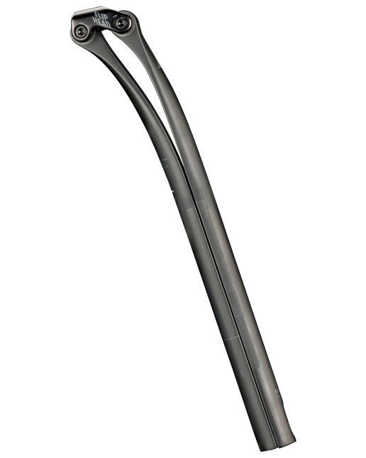

You don't need one, but I've got one of these ...
https://www.canyon.com/en-gb/gear/bike-parts/contact-points/posts-and-clamps/canyon-s15-vcls-2.0-cf-seatpost/148287.html
and it's the absolute mutts nuts.
Posted : 07/06/2022 9:13 pm
Posts: 1910
Those Canyon posts are very good. One came on my grail and although you don’t feel any movement while riding, my friends said you could see it working on the rough stuff. Only issue is grit and small stones get in the gap and start to rub. I covered the area with a strip of helitape but it still started to eat in. Resorted to cutting a wedge of Moto foam to fill the gap and it’s been perfect since. Flip head came be rotated as well to vary amount of set back.
