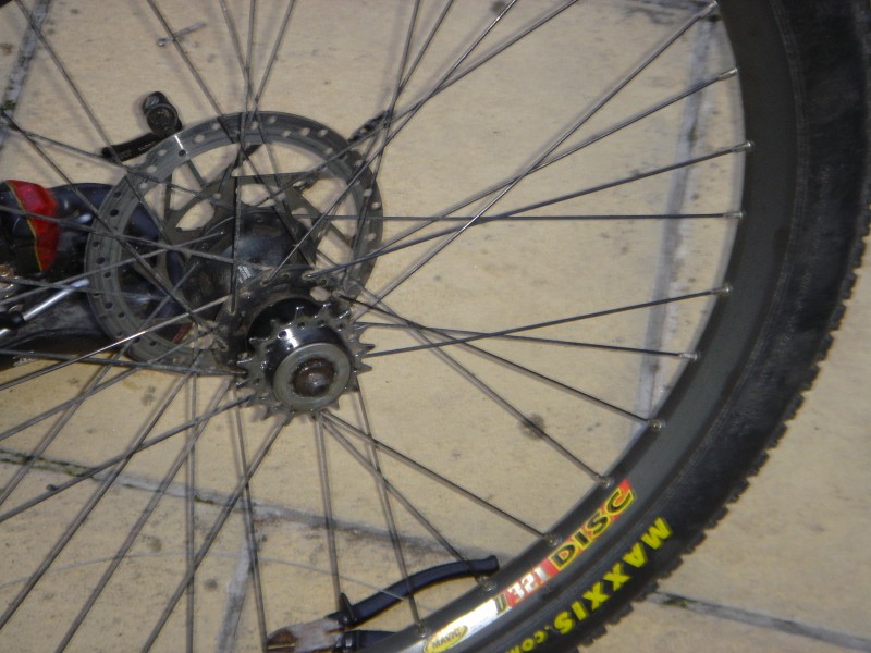

Well, Friday night in the company of Badger's Golden Champion and we have made progress.
Fun doing, lets see if it's fun riding!
Posted : 12/06/2009 11:10 pm

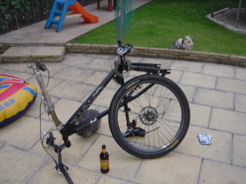

and you have a bottle of Badger Golden Glory too... good on ya... a mechanical pro then 😉
Posted : 13/06/2009 10:02 am
Posts: 12148
That was the finished article in that last pic after consuming one bottle of beer.
Yeah you'll need another wheel and that's upside down.
Mail me in profile for anymore help.
Posted : 13/06/2009 10:04 am
Posts: 7388
Lol @ oldgit. Nah, it's complete and should get a spin tomorrow night.
