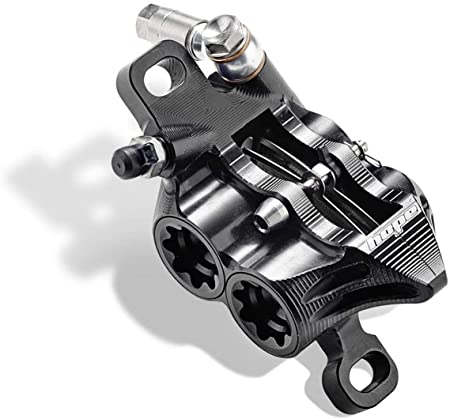

Posts: 4626
Yeah I thought Trickstuff + Hope E4 when I saw it. Even looks like it uses E4 pads.
Posted : 03/06/2022 9:21 am
Posts: 11774
Those 4 pot brakes...have they got 4 pistons in them? Looking at the pics, 1 side looks very narrow to have pistons in. The other side looks twice as wide.
Posted : 03/06/2022 9:22 am
Posts: 16383
Yes. Both pistons are fitted from the same side so one side has the piston and the plug that fills the hole. The hopes pictured above are the same
Posted : 03/06/2022 9:39 am

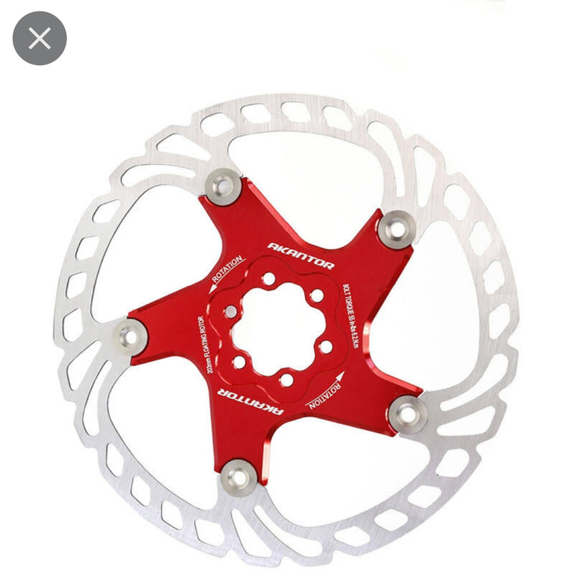

Posts: 502
[url= https://i.postimg.cc/0QHbqbfD/Screenshot-2022-07-10-22-01-27-62-40deb401b9ffe8e1df2f1cc5ba480b12.jp g" target="_blank">https://i.postimg.cc/0QHbqbfD/Screenshot-2022-07-10-22-01-27-62-40deb401b9ffe8e1df2f1cc5ba480b12.jp g"/> [/img][/url]
If you're looking at cheap Chinese made floating rotors for your front end I wholeheartedly give a thumbs down to these.
203mm 6bolt used with a Shimano MT420 system, with both resin and semi-sintered pads, cleaned, roughed up, bedded in.
Power isn't there. You can feel every cutout on the braking surface (that i don't actually think now is a braking surface!) If gravity usage is the order of the day (pointing downhill, mountain roads, trying to bleed off speed at anything over 20kph, etc), something goes horribly wrong and with each pull of the lever, the lever gets closer and closer to the bars.
I've just bought a replacement Shimano RT66 203mm 6bolt rotor (made in China) and can now lock the front wheel up. Big eye opener after a while thinking I'd done something wrong, the rotor is definitely at fault used in the front.
Posted : 10/07/2022 4:12 pm

I can confirm the M4's accept Hope E4 brake pads. I got the Uberbike E4 pads as they are good quality and a lot cheaper in the long run as you can buy pads separately to the finned backing plate. The fins don't fit in as closely to the caliper body as the originals but in the short test ride I took to bed them in they felt really powerful. Looking forward to testing in anger next weekend.
