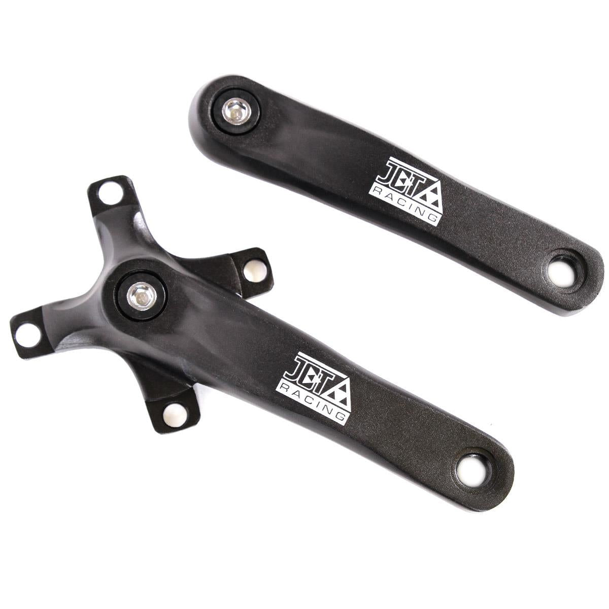

They'll be fine, I've been running Jet Racing BMX  cranks on my lads CX / Road bike for a while, they're no more than about £40 a pair, when they're in stock

Just bought these for my 10 year olds bike.
https://www.sourcebmx.com/products/jet-bmx-square-taper-race-cranks
Bought a Raceface narrow wide chainring from Wiggle for less than £15.

Alternatively get a Deckas ring off eBay for less than that, they're bloody good too. The packaging is suspiciously like some posh brands 😉
 It looks like they’re all pretty much from the same factory then? Good to hear positive things.
Well the Jet Racing and the micj more expensive Kids Racing HUP ones seem to come from the same place

I also just bought the Jet Racing cranks and that Race face ring. Second the comment regarding length, my daughter is getting 140mm for her 24" setup, depending on age I'd be looking at 150 to 160mm.

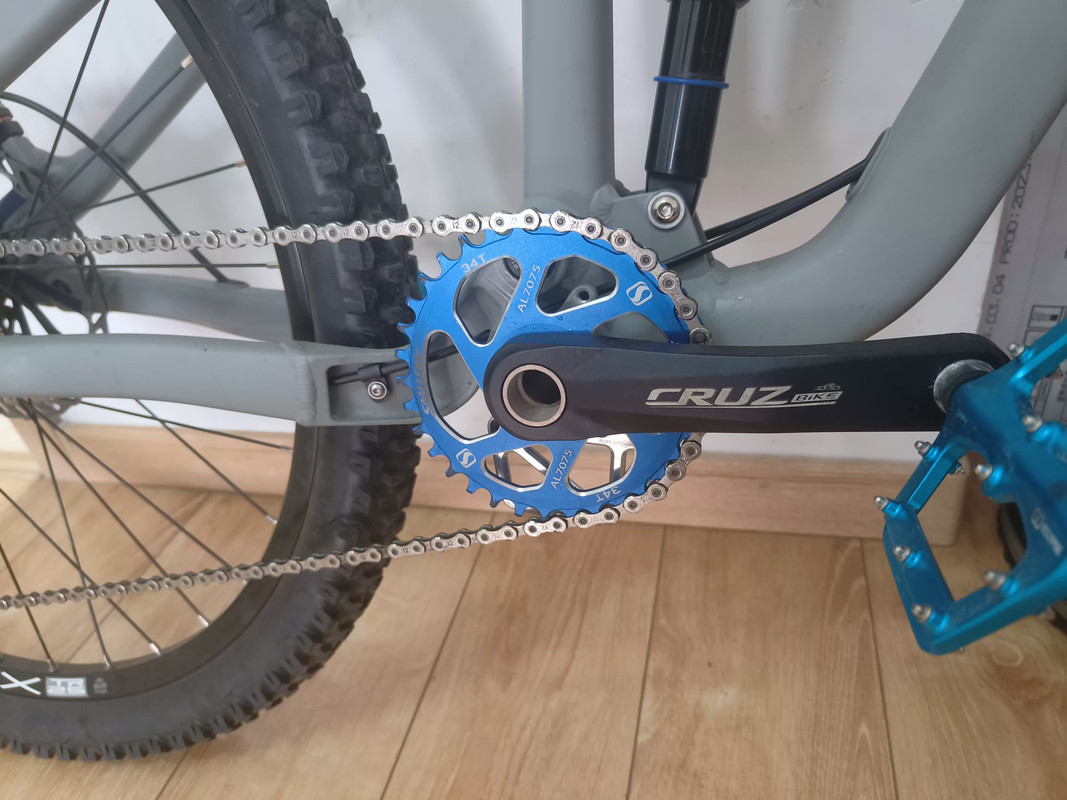

Can you use AliExpress and wait a touch?
Look for Cruzbikes mountainbike GXP cranks. They come in 155/160/165/170 lengths. Be perfect for a teenager. Just need a suitable BB, and GXP chainring to suit (3mm offset for boost, 6mm offset for 135-142mm rear.
[url= https://i.postimg.cc/13KgVN4v/Screenshot-2023-07-31-11-56-44-38-090d9ae461b065ca11c329abb9cd0d70.jp g" target="_blank">https://i.postimg.cc/13KgVN4v/Screenshot-2023-07-31-11-56-44-38-090d9ae461b065ca11c329abb9cd0d70.jp g"/> [/img][/url]
They're gonna cost a bit more than here in China, but they're £17.75 here for the cranks. £6.53 for their own chainrings, and the BB is upto you.
[url= https://i.postimg.cc/MTJVy8qD/IMG20230731120147.jp g" target="_blank">https://i.postimg.cc/MTJVy8qD/IMG20230731120147.jp g"/> [/img][/url]
I'm using a working VPN, because.....China....Deutschland server working. Here's the price in Euros for a full 165mm 6mm offset 34t set (€54.49)
[url= https://i.postimg.cc/fb8fmR8h/Screenshot-2023-07-31-12-05-57-02-40deb401b9ffe8e1df2f1cc5ba480b12.jp g" target="_blank">https://i.postimg.cc/fb8fmR8h/Screenshot-2023-07-31-12-05-57-02-40deb401b9ffe8e1df2f1cc5ba480b12.jp g"/> [/img][/url]
