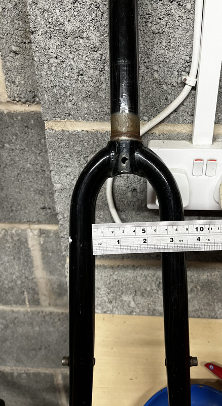

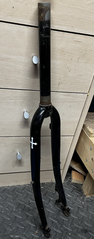

If you don't need loads of tyre clearance, you can have these for a tenner. Off a genesis Croix de fer.
PM me.

@superficial what clearance do those have? Never could find out...
Posted : 14/07/2023 8:58 pm
Posts: 6859
@squirrelking - approx 62mm between the legs. Very gentle taper. I was using 700x40mm tyres with more than enough clearance.
