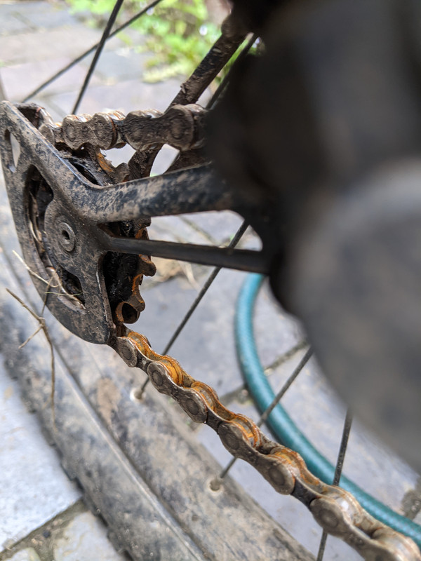

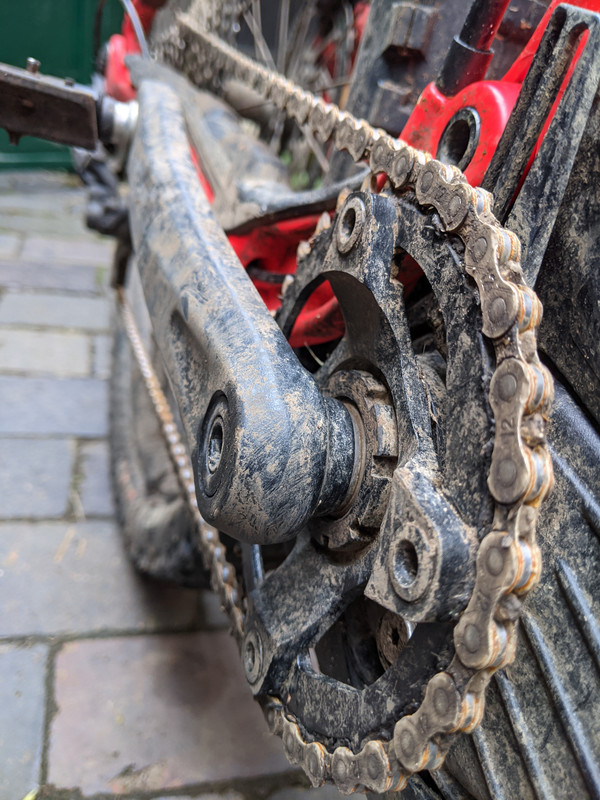

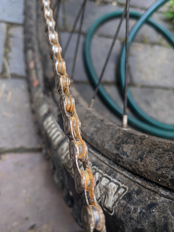

I've been using Putoline for a couple of months now. Still struggling to see why it's regarded highly. Must be where the bike is used.
This is one ride last weekend in the muddy Gloucestershire hills, and then left until today. I thought the idea was that you didn't have to do anything until next application?
It's fantastic the first ride after application. Lovely and quiet, but yeah. This is a week in the shed.
Posted : 10/07/2021 12:19 pm
Posts: 35671
euuurgh, that's not good!
Posted : 10/07/2021 1:15 pm
Posts: 7941
Thats my experience of it.
Posted : 10/07/2021 2:03 pm

I've advocated it until now because my experience was that for (let's say) a monthly application you could then ride and mostly neglect drivetrain OTHER THAN a quick wipe down with a rag soaked in GT85 after every wet ride. This kept the chain shiny and clean looking, no gunky black mess, quiet and smooth. Would probably have avoided that horror show up above ^
The first ride after each application was bliss, I could swear I felt the whole bike was faster. After that it was just 'good'.
Problem is, as of yesterday I've decided to stop using it. In some respects it is almost *too* good and you get lazy, which means I've now finished at least 3 if not 4 long mixed rides with a dry squeaking chain. Especially horrible on the gravel bike when you might have 15km of tarmac to get home.
Not really Putoline's fault, it will still have outperformed any other lube, but at least something light and easy to apply then wipe off means you can just apply every couple of rides and be guaranteed it won't wear out mid-ride. I think it is best suited to those who track mileage more fastidiously than me, and even then I think the re-application would be too frequent for my liking.

Yeah I can only imagine the Putovangelists don't really ride in the worst of conditions.
Maybe they're more talking about commuter bikes.
I don't recall them saying you did anything other than apply it every few rides.
I've stuck the chain in the Putoline today but I think that'll be the last time and I'll go back to Squirt every ride.
Shame though as I bought the tin and a deep fat fryer based on what folks said on here.

I've ridden in some pretty shocking conditions and have never had my chain looking like that @kayak23. I do dry the chain with a rag rather than leaving it to dry and develop surface rust though. It's also stored in a heated garage which probably helps.

Yeah for what it's worth (putting evangelist hat back on) Putoline worked brilliantly in foul muddy conditions, possibly the best a drivetrain of mine has worked in mud deeper than your rim etc. and it only took a minimum of care after the ride to keep it looking good. It's only the unpredictable application intervals that has forced me to switch (and yeah, maybe the build-up of black gunk around my jockey wheels, that stuff WILL find it's way on to the bottom of your shoes and onto the carpet eventually...).
