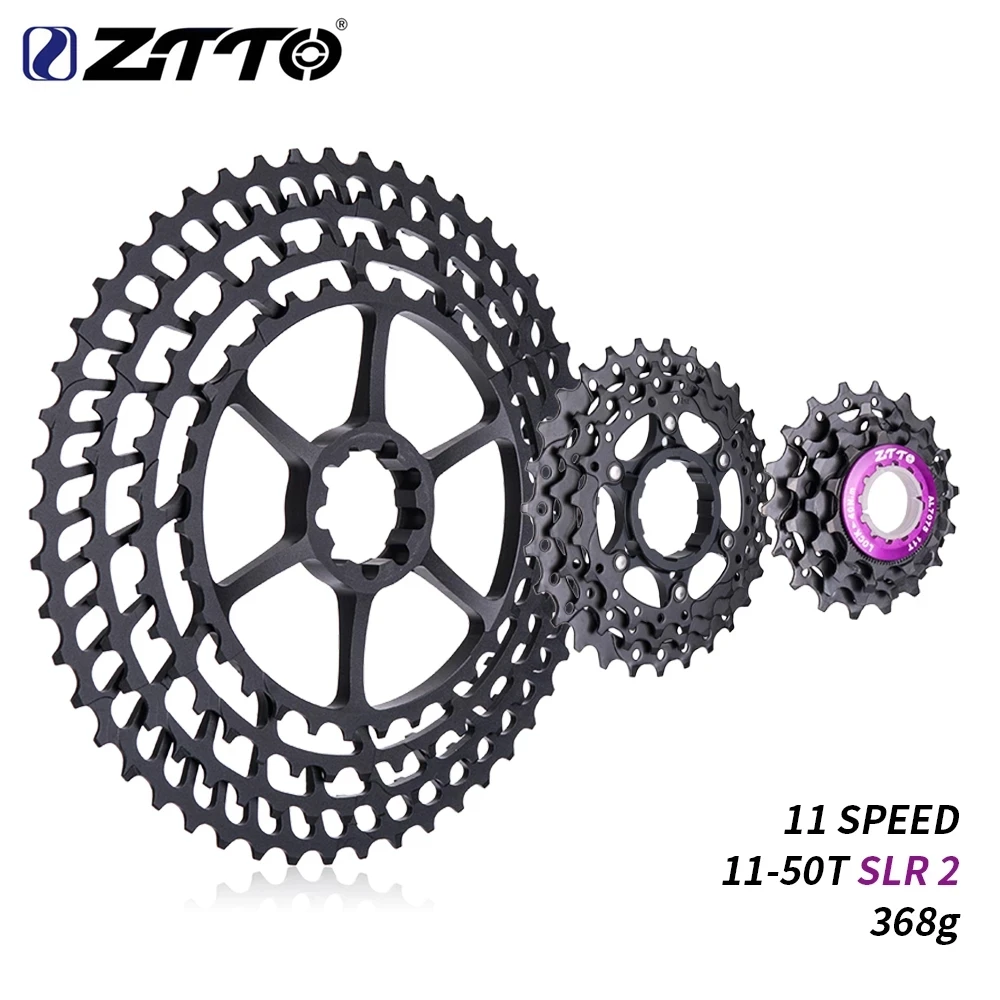

Posts: 874
I've got an 11-50 11sp ZTTO, https://www.aliexpress.com/item/32901149094.html?spm=a2g0s.9042311.0.0.27424c4dRg9MWI
For various reasons I haven't used it much, so can't comment on the longevity, but it shifted fine. Not great, but OK with a standard 11sp XT mech.
I'd get another.
