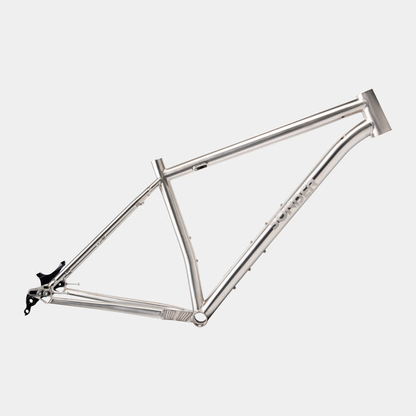

Posts: 10109
I realise it’s not carbon but a Sonder Broken Road would fit all your other criteria
https://alpkit.com/products/sonder-broken-road-ti-frame-only
Posted : 09/11/2024 11:38 am
