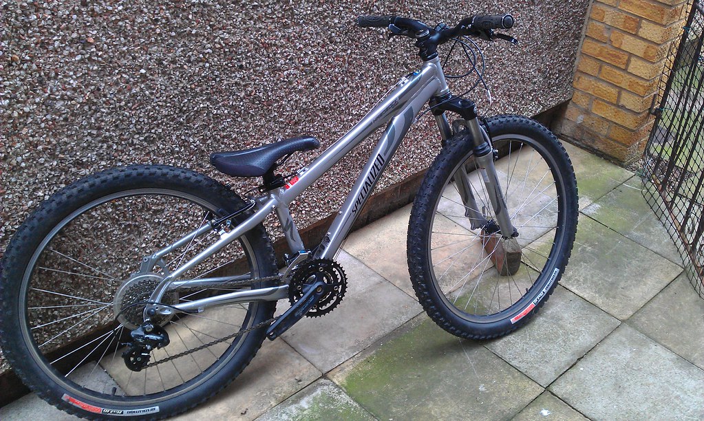

Spesh do a 13" Hotrock...I picked one up for my lad...
[url= http://farm9.staticflickr.com/8475/8434185000_eee1d4ccec_z.jp g" target="_blank">http://farm9.staticflickr.com/8475/8434185000_eee1d4ccec_z.jp g"/> [/img][/url]
[url= http://www.flickr.com/photos/takisawa2/8434185000/ ]IMAG0109[/url] by [url= http://www.flickr.com/people/takisawa2/ ]pten2106[/url], on Flickr
But inside leg measurement aside, it's just still too much bike for him to handle. Ended up getting him a 24" version. Just need to rebuild his front wheel onto a disc hub, & he will have a front disc brake (BB5 to keep the same lever), & rigid Exotic fork.
