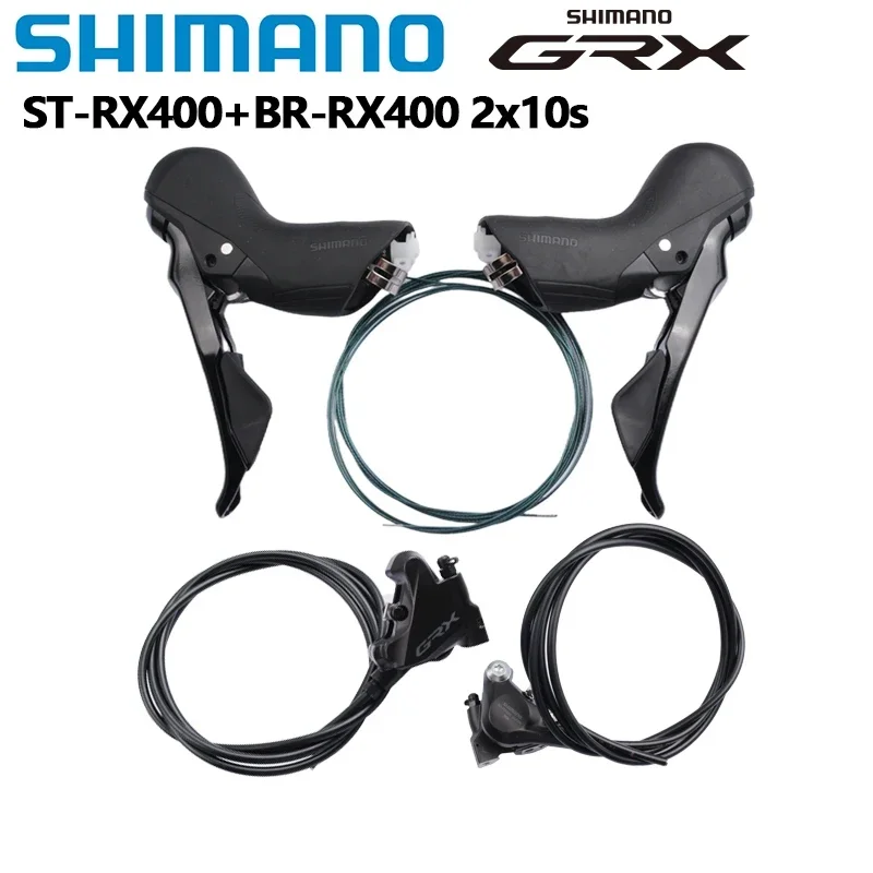

Posts: 1805
Posted by: tthew
Posted by: Gribs
They don't have to. Mechanical hydro Shimano brifters are available for about £200 a pair on aliexpress.
That's not a full hydro set that fooman suggested though is it?
Yeah. 105 or Grx 12 speed including hydro callipers. 11 speed 105 is a similar price or 10 speed grx is about £160.
https://www.aliexpress.com/item/1005010444109607.html
Iiipro make a system similar to the Giant or Hope hydro system for about £50. There's no reports yet on long term reliability and it's ugly.
https://www.aliexpress.com/item/1005008324673203.html
Posted : 15/01/2026 6:28 pm
