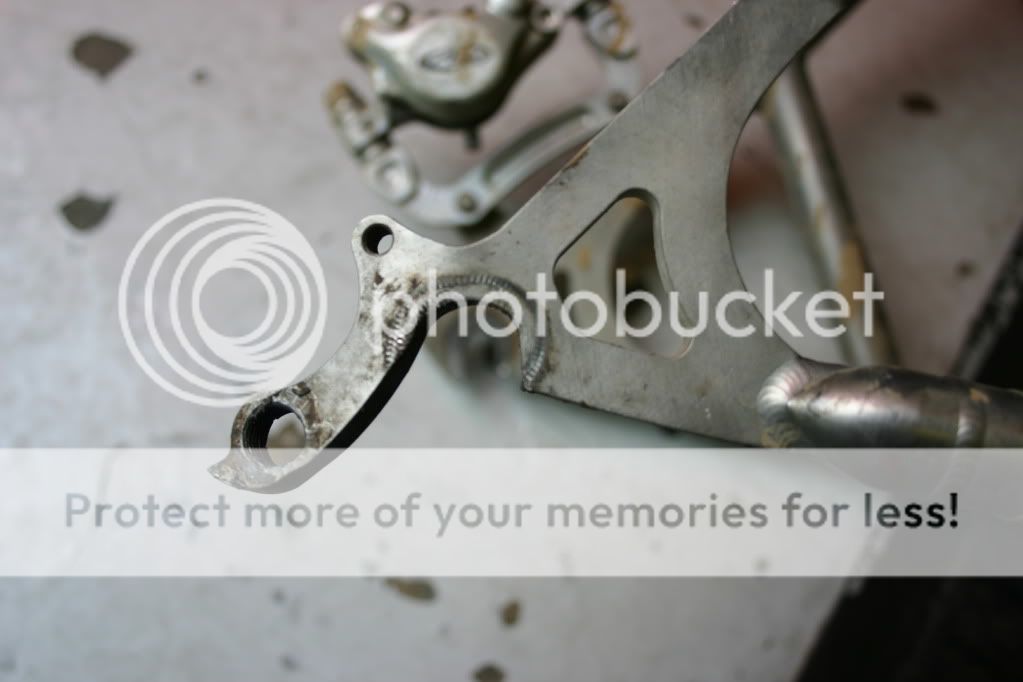

Managed to crash this morning, seriously distorted by built-in mech hanger plus opened up the drop-out of my 456Ti - luckily the XTR mech took most of the impact... double bugger.
Never mind the scarred forearm and highly bruised thigh.
Oh yes, and the chap I managed to clip - probable broken bones in wrist/thumb/hand etc and big bleeding across both legs - sorry Colin 😳
And according to my GPS, at 28.5 mph!
Any clues/ideas on realigning said hanger and closing up the drop-out?

Ti needs to be worked cold so just bent it back [b]carefully[/b] with a big adjustable. Then take it to an LBS with a gear hanger alignment tool to make sure it's straight.

hope this may help with some opinions on the best way forward..

A remarkable photo, normally when trying to bend / distort titanium (alloy 6/4 etc) that much when cold it just snaps. So it is possible that it is commercially pure (the dropout that is, not the tubes).
It is possible to heat titanium to reshape it, as long as you stay well below 800 degrees celsius. Titanium will readily combine with nitrogen at 800 degrees c and above.
There is the problem of forming an alpha case on the metal (crystaline structure) when heated, and titanium does not look pretty after heating in air (or any active gas). Therefore a possible way to heat it is in the shield gas (argon) of a TIG torch.
It is therefore:
1 Try to bend back cold and it might snap and it will not look great.
Hold the gear hanger very firmly in a vice and pull the frame around till it looks OK.
2 Try heating it with TIG arc in argon shielding (if you can find anyone to do it) not going to be easy, or look pretty.
3 Get the damaged part only removed and a fabricated replacement gear hanger welded on, again not going to be easy finding someone to do it.
Ceeway might know someone to do it.
Posted : 27/04/2010 6:30 pm

First up - call On-one. They might do a crash replacement deal?
I got my oldman (has his own company and workshop) to fix a badly bent alloy stay for me once. He staightened it, kept it at the right temperature and annealed it for me.

If its CP Ti (DEFO ring Brant to find out the spec) you could be in luck, its bends OK cold. 3/2.5 will also bend cold. Do be carefull though!
6/4 *can* be bent cold, but you need large bend rads (which you cant control in this instance) and there is always a chance it will crack (acceptable risk on a "low" value bracket, but not on a frame).
A pre-bend anneal (730 deg C for 1/2 hour) will improve cold bending no end. But how you heat treat the frame (bare in mind the problems associated with heating Titanium) I dont know.
You could have the drop-out replaced, but you're stuck with the usual problems with finding a fabricator that can do it.

That's probably me. 🙂 Although it was an 853 Inbred. And it was a LOT worse than that. Mine was so bad the hanger locked the cassette solid!
Firstly, you've got nothing to loose by trying to bend it back. It's not useable as it is, so you might as well try.
Secondly - TAKE YOUR TIME WITH IT!!!! Don't start hitting it with a hammer! If it's going badly, WALK AWAY and try tomorrow!
I stripped the bike down so I could put the frame in a vice, then firstly got the hanger roughly straight. The thing is, it might not want to bend back in the same place it bent in at, if you see what I mean, so you have to be careful to clamp the hanger in the vice, and use the edges of the jaws to get it to bend back in the right place. It's NO USE trying to do it any other way, you risk having an 'S' bend in your hanger!! Seriously!
Clamp the hanger in a the vice, use the frame as leverage.
Then, when it's roughly straight, you need to get the dropout closed up. Again, it might not want to bend back in the same place, so you need to ensure the dropout remanins 'dropout shaped' and not teardrop shaped!
I got an old hub axle and a couple of nuts, which I clamped into the dropout, to use as a 'former' if you like. Then I clamped some molegrips on the dropout, so the jaws were on top and underneath the hanger (Handle pointing backwards) and then turned the frame upside down and sat on it, so I could pull the dropout towards me round the axle, and see what was happening. I also screwed a bolt into the mech thread, so I wouldn't close the hole up as I was bending, or from the molegrips
Like this
Then I used a hanger alignment tool to get it spot on. You can't guess this, just buy the tool, IMO!
End result, burrs filed off, wire brushed clean.
That was 3 years ago now and it's been fine ever since. 🙂

It'll bend back!
Many years ago I had one of the Raleigh SPD Ti frames (the fully Ti welded ones not the glued together TI and steel versions) and I managed to stuff the mech into the back wheel bending the gear hanger in the process.
Dropped the bike of at Roberts and a few days later it was all sorted, they simply put a big tool on it and bent it back.
Posted : 28/04/2010 9:18 am
Steel dropouts are malleable at room temperature and are relatively easy to deal with.
Titanium alloys (alpha beta alloys) are not so malleable at room temperature.
However just on the basis of looking at the picture the titanium drop out appears to be malleable at room temp. So it must be Commercialy Pure (CP alpha structure).
So, it probably will be possible to straighten it out at low temperature.

Std practice in LBS is to use the hole in the end of an adj spanner to bend the dropout back in place. I uses the jaws to straighten them also - it's not diffcult to align it by eye and check with a rear mech IMO.

Even for steel dropouts it is still easier and neater to hold the dropout in a vice and twist/turn the frame about to do most of the work. Then fine tune with the right tools. Dropout alignment gearhanger alignment.

Discussions have taken place with On One, who also spoke with Mark Lynskey.
Attempt to bend it cold, if it fails On One will ship it to Lynskey for a new drop-out for the cost of the postage. I'm happy with that, so now down to the LBS via the coffee shop!
Will report back.

Just spent an hour or so at my LBS, and we managed to get it back into a usable position with the drop-out almost closed up. Lots of patience, tools, vice, work stand and good luck it seems. And of course Andy the mechanic, thanks to Buckingham Bikes.
So rebuild it this afternoon and see how it rides.

Now rebulit and running fine.
Drop-out not fully closed up, but I'll monitor it and if it gives me problems ship it off to Lynskey for a new drop-out to be welded-on.

Update.
Wasn't fine. Couldn't get the 'axle-hole' below 10mm...
So sent to On One, who've sent it on to Lynskey.
3 months later it came back, via On One, including a few weeks in East Midlands airport customs...
Fantastic job, frame re-finished and I believe a new drive-side triangle.
£100 all in - so very happy.
Next time though I'd probably just send it to a UK-based company with the skills - Enigma maybe ( http://www.enigmabikes.com/) - so hopefully I'd get it back a bit quicker.
