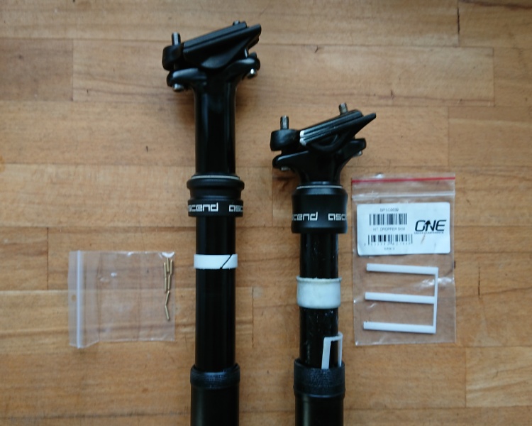

I meant to update the Brand X thread from last week but I've been a bit busy.
I had a go at shortening the 2020 Brand X post, you can tell the versions apart by the collar. New on left, old on right. You can see how the OneUp shim fits the post on the right.
Old vs new Brand X
I also have the 10mm OneUp v2 metal shims (I've a lot of droppers) but the 2020 Brand X doesn't seem to have the grooves just below the collar to fit them. Could be I didn't take the post apart enough but I suspect while they may still be similar internally it might be some extra machining OneUp do to the parts specially for the metal shims.
