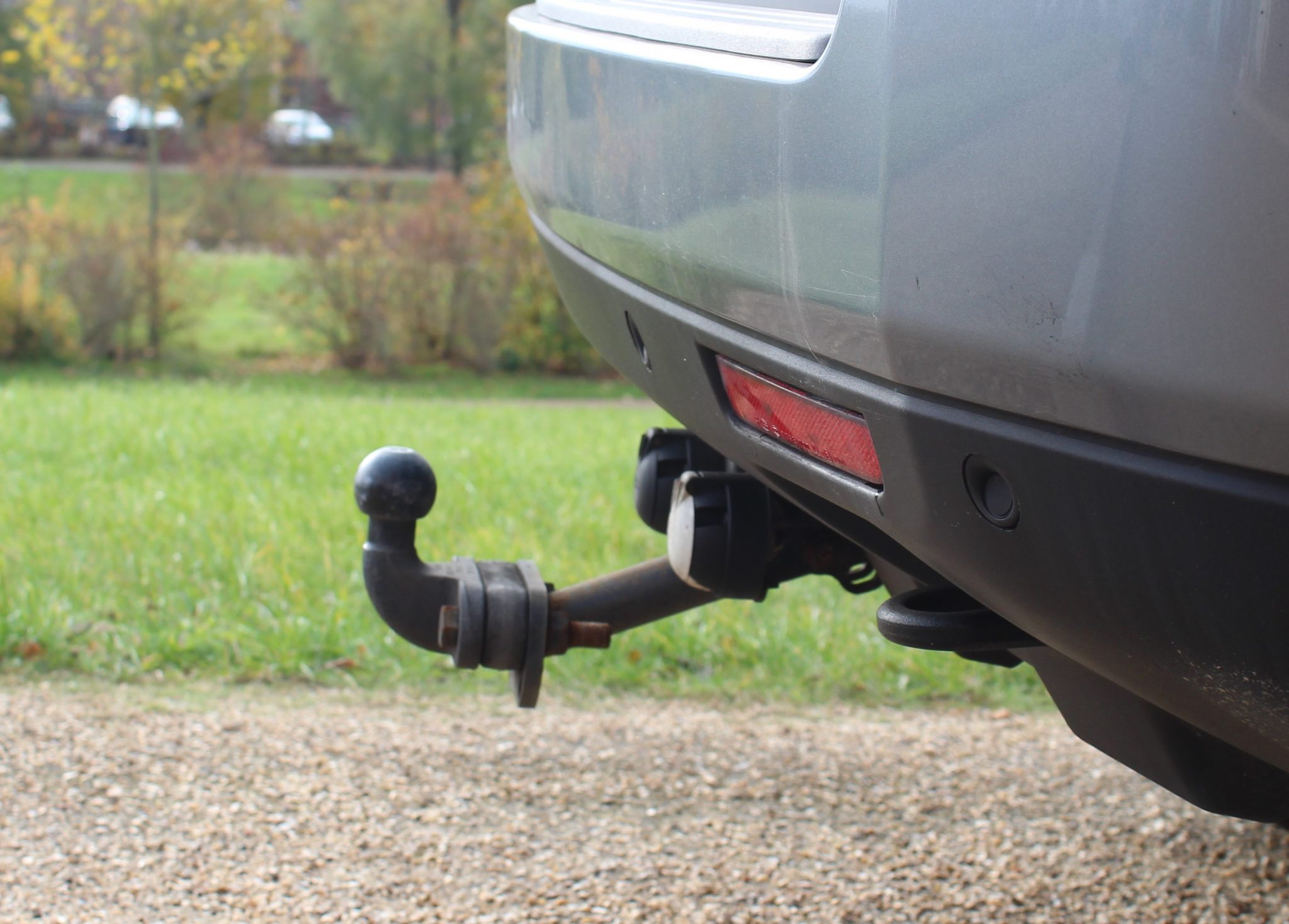

If you go down the towbar route, then there are quite a few options and I made a small guide for this to.
https://auxtail.com/towbars/
