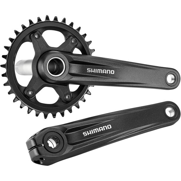

I’m guessing this would work for the crankset as the Alpine is non boost but says it works with both 142/148.
https://sportandleisure.com/products/shimano-deore-fc-mt510-1-x-12-speed-boost-chainset?variant=56063683297667&country=GB&currency=GBP&utm_medium=product_sync&utm_source=google&utm_content=sag_organic&utm_campaign=sag_organic&gad_source=1&gad_campaignid=23014340359&gbraid=0AAAAADKtyDCPdyBPw9nU_obLq2riwOvDY&gclid=EAIaIQobChMIur-s9-yXkgMVIJNQBh1brBBsEAQYASABEgL90vD_BwE
Seems a good price also - probably just need to get the BB. Would I have any compatibility issues with the shifter and derailleur being SRAM?

The chainline using that crank above would be crap!
Posted : 19/01/2026 6:24 pm
