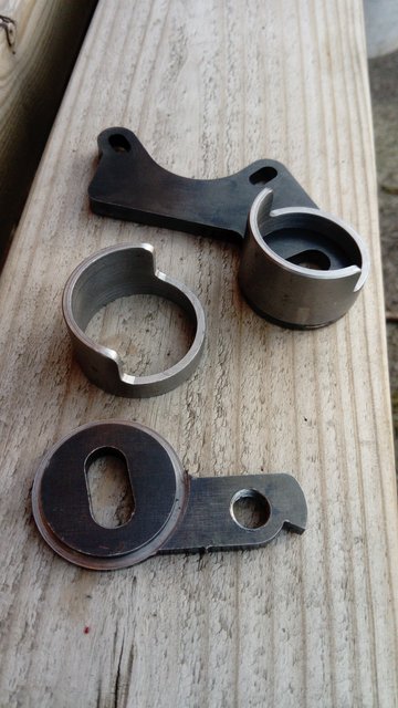

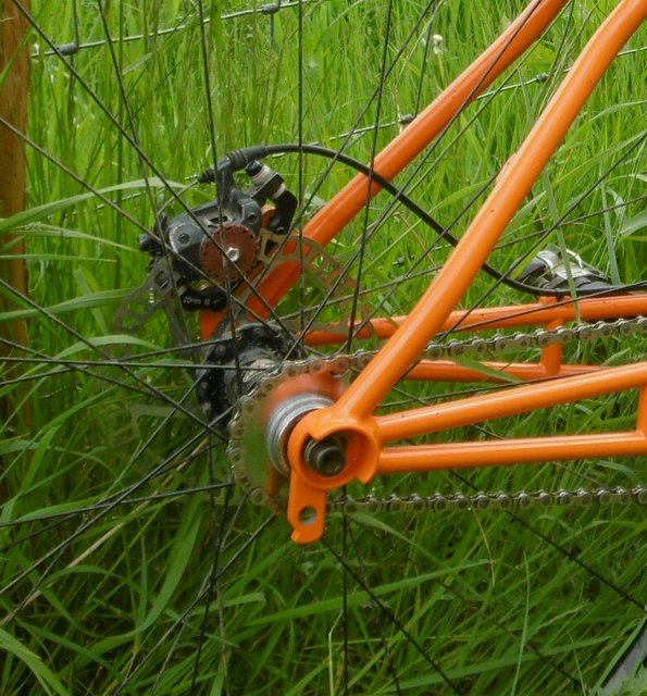

I quite like variations on horizontal with a bolt in hub / nutted axle.
Current favourite is a short horizontal slot with closed ends. Hope 135mm axle with 10mm bolts so the wheel just drops out vertically.
[url= https://i.postimg.cc/VkmPjtqd/DSC-0473.jp g" target="_blank">https://i.postimg.cc/VkmPjtqd/DSC-0473.jp g"/> [/img][/url]
[url= https://i.postimg.cc/s23SdTps/20201015-195857.jp g" target="_blank">https://i.postimg.cc/s23SdTps/20201015-195857.jp g"/> [/img][/url]
[url= https://i.postimg.cc/WzN1WyrJ/P1000867.jp g" target="_blank">https://i.postimg.cc/WzN1WyrJ/P1000867.jp g"/> [/img][/url]

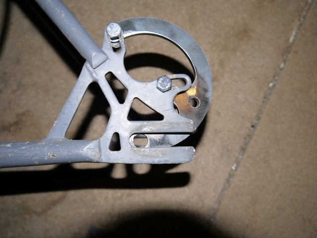

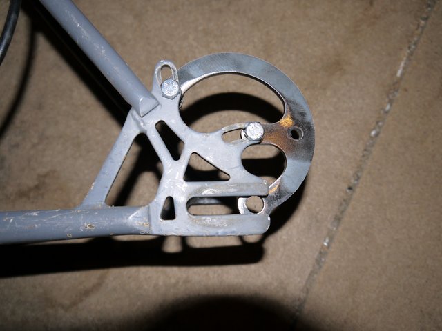

Posts: 3675
Thanks!
They are just laser cut blanks and some simple lathe work. 2 parts brazed together before brazing to the frame. If you are having something made I can send the CAD file.
The curved disc tabs are an idea stolen from Bianchi USA. Slot lengths are roughly 2:1 axle adjustment to caliper movement.
[url= https://i.postimg.cc/qBtSPwJP/P1030926.jp g" target="_blank">https://i.postimg.cc/qBtSPwJP/P1030926.jp g"/> [/img][/url]
[url= https://i.postimg.cc/15rH2VFx/P1030925.jp g" target="_blank">https://i.postimg.cc/15rH2VFx/P1030925.jp g"/> [/img][/url]

@mick_r - Bit of a cheeky ask but do you have a drawing for the brake positioning guide you would be able to share? I've been meaning to make one for years but never seem to get around to doing it.

Jonm81 - I'll try and dig the drawing out. Do you want a dxf file to get one cut? If you want one ready to go then I can get one zapped out next time I send some profiles. Would be foc plus post.
