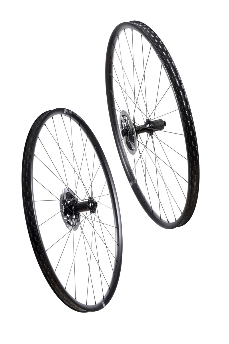

Hunt 4 Season have been great for me.

Not sure the Hunts are ideal for the heftier rider.
To quote Hunt's website "100kgs is the upper recommended rider weight limit for these wheels. Please include the weight of any luggage in your total rider weight when choosing the correct wheels. If a rider is over 90Kgs then an experienced bike mechanic should check the wheel regularly"
Maybe look at THESE, they have a 130KG weight limit.
Or have a word with a decent wheel builder like Moonglu or Twenty20.

Posts: 14040
hatter
Not sure which wheels you're looking at, but for both variants of the 4-season gravel, "115kgs is the upper recommended rider weight limit for these wheels." I'm more than 95kg and have not touched a spoke in over 3 years.

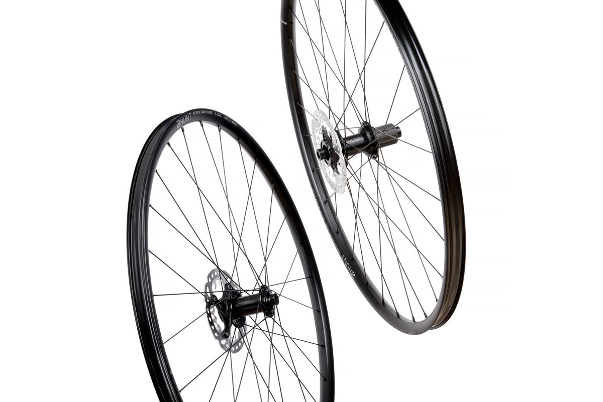

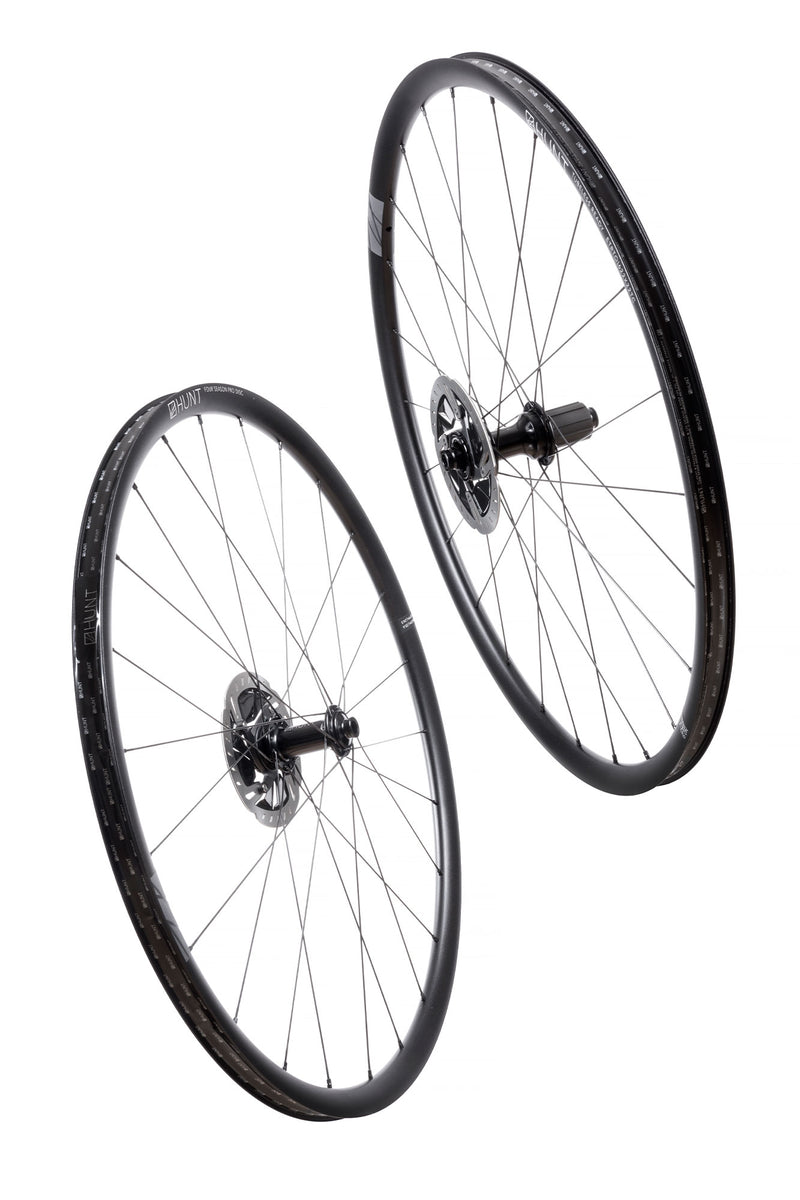

It was the Hunt 4 seasons, the section I posted was at the bottom of this page.
MASON x HUNT 4 Season Disc Wheelset
Right - they have three different 4-season gravel - the "normal", non-Mason version and the X-Wide have higher limits, I think the Mason version is a sort of race one, fewer spokes.
https://eu.huntbikewheels.com/products/4season-gravel-disc-wheelset
https://eu.huntbikewheels.com/products/hunt-4-season-gravel-disc-x-wide-wheelset
Posted : 23/06/2022 10:08 am
