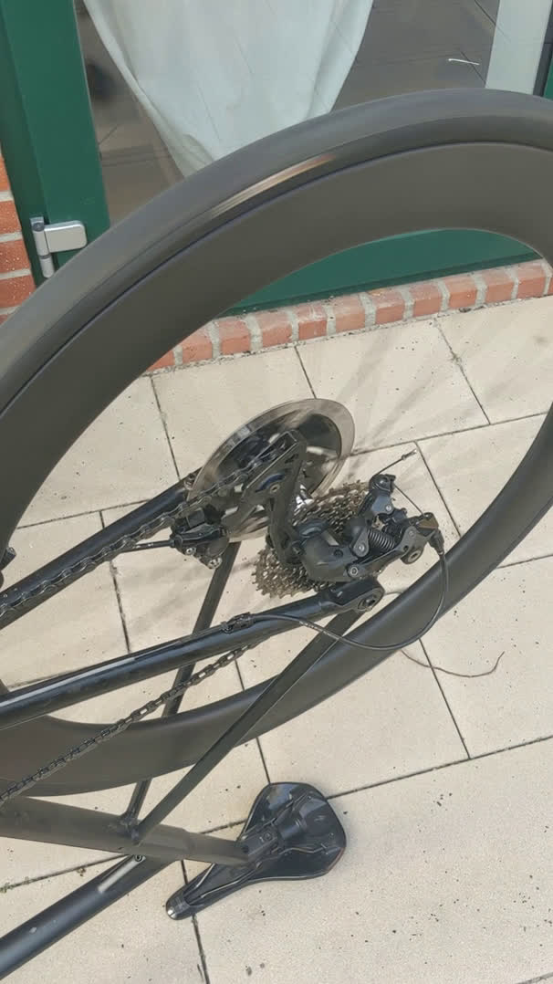

Can't you hear it's going bzzzBZZZZbzzzBZZZZ oscillating like something is broken?

Can’t you hear it’s going bzzzBZZZZbzzzBZZZZ oscillating like something is broken?
That's just the wheel being out of balance, nothing to do with the hub. There will be variations in the carbon, the tyre and, of course, there's the valve to consider.

That’s just the wheel being out of balance, nothing to do with the hub. There will be variations in the carbon, the tyre and, of course, there’s the valve to consider.
I balanced the wheel, no difference, and it's the same on every youtube video sound test for DT hubs.

OP - what did you use for balancing the wheels. Lead was always the "best" option but is now shunned on health grounds. Solder works well if it's small adjustments.

OP – what did you use for balancing the wheels. Lead was always the “best” option but is now shunned on health grounds. Solder works well if it’s small adjustments.
Lead golf weights about 3 grams each taped to the inside of the rim, what's the health concern?
