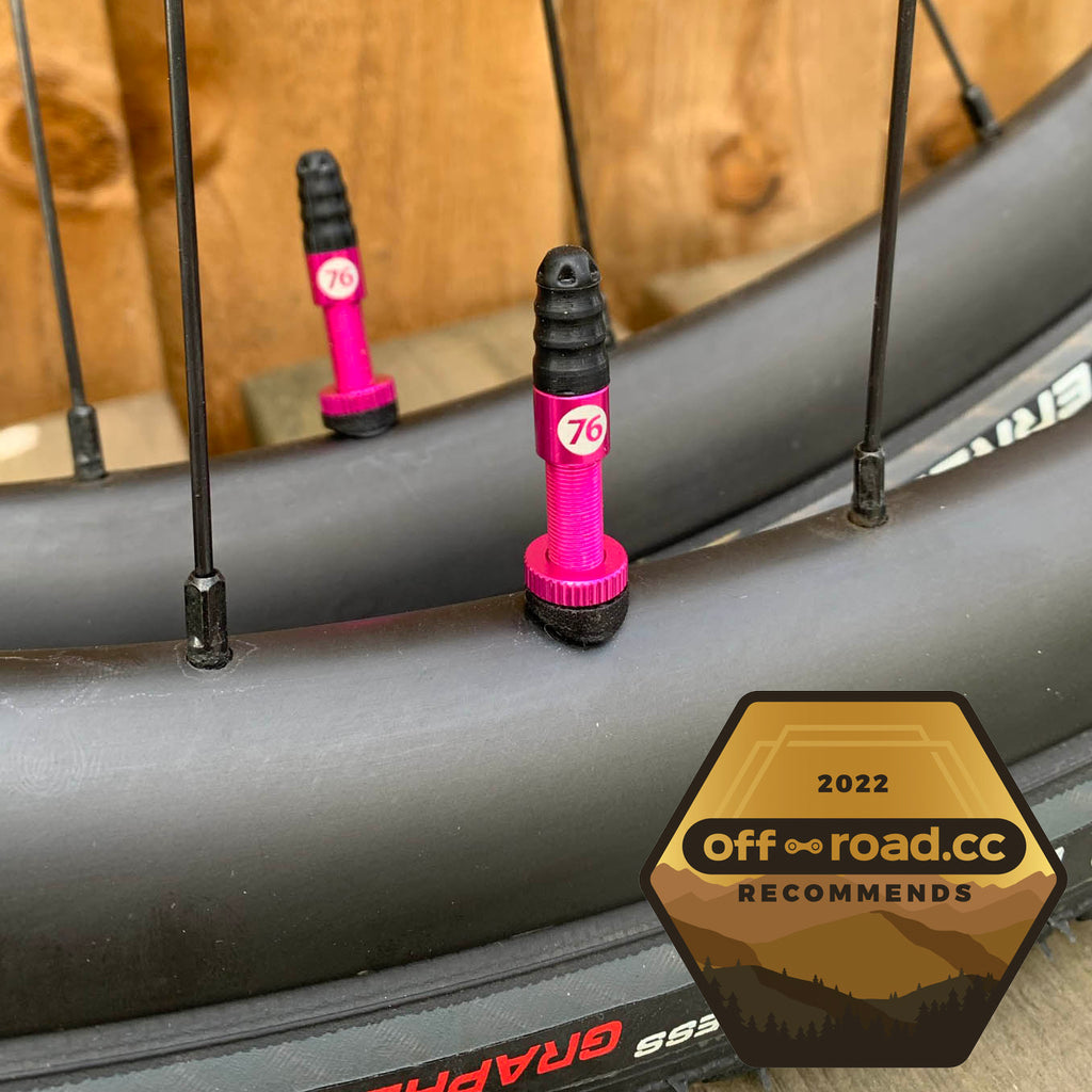

Posts: 5054
All the standard ones pretty much work the same, but these are better IMO (+15 years of tubeless):
https://76projects.com/products/hi-flow-no-clog-tubeless-valves

Posts: 3330
Standard valves all much of a muchness, however I got fed up with clogging and bought 76-projects and they are night and day better. It is noticeable how much easier they are to inflate and how much more air goes in at a time.
My new wheels then came with Reserve Fillmore's they're also good, maybe not quite as out and out high volume but still way better. For their cost I'd not by Fillmore's on their own, but I'll only be using 76 from now on if I have to buy them.

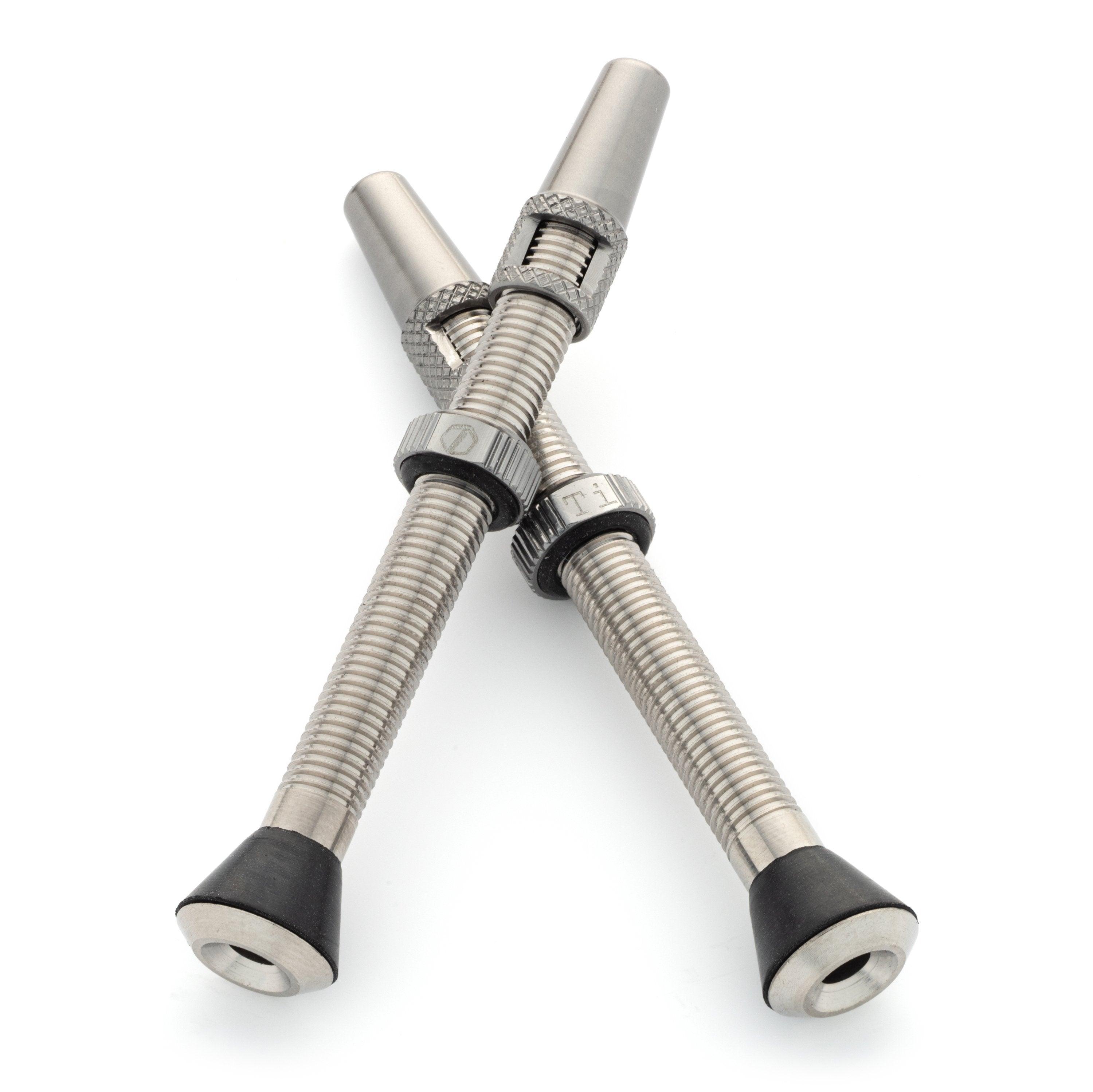

Posts: 12553
https://lindarets.com/products/titanium-tubeless-valve-stems
4 times stronger, 86% bigger hole, replaceable bits, colours, titanium. What more do you want?
