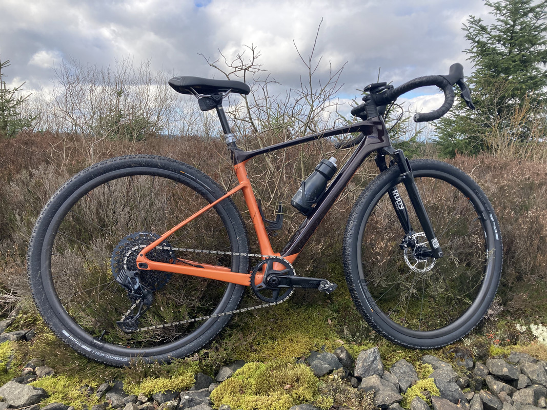

I am fortunate to have 2 nice gravel bikes, one with and one without. The Revolt X is setup more for singletrack and gravel, the Diverge for gravel and road.  They ride quite differently as a result, and for what I use the Revolt for, the dropper is ideal. It tends to be used on stuff that I used to use a 29er HT for. I do also have a FS eMTB tho.
[url= https://i.postimg.cc/7LDBq6Qp/IMG-2225.jp g" target="_blank">https://i.postimg.cc/7LDBq6Qp/IMG-2225.jp g"/> [/img][/url]
[url= https://i.postimg.cc/rw5n6Wg1/IMG-2504.jp g" target="_blank">https://i.postimg.cc/rw5n6Wg1/IMG-2504.jp g"/> [/img][/url]

^^ I can't really fault it, though I did get the supplying LBS to swop out the Giant dropper to the Reverb AXS, as the oem one gets mixed/poor reviews.  The wee rubber seat tube cover hasn't moved on mine, but forums suggest others find it pops out - I put a bit of grease on mine and it's fine so far.

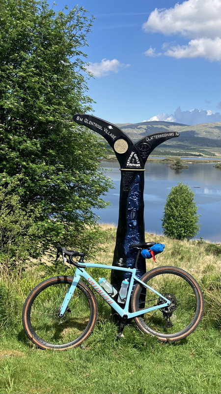

https://flic.kr/p/2pUgQBG
