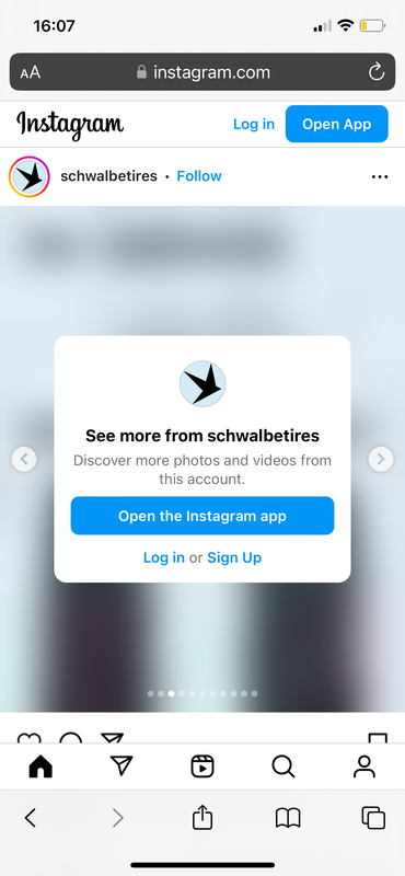

Fiddlesticks! Was quite looking forward to flicking looking ant that and then, second slide in….
[url= https://i.postimg.cc/ydTNdW8z/IMG-0173.pn g" target="_blank">https://i.postimg.cc/ydTNdW8z/IMG-0173.pn g"/> [/img][/url]
don't have an instagram account so a bit stuffed, cant seem to find it anywhere else either
