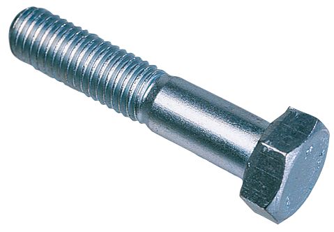

I have a possible alternative solution...
My Kona has slidey dropouts like:
It currently has M8 hex bolts instead of those allen bolts in the pic. If I get some partially threaded hex bolts, I can tighten a nut to the end of the threaded section (or lock two nuts together) and use them to replace two of the existing bolts. Then the un-threaded section between the nut(s) and the bolt head will allow the trailer to be attached. A very rough measure suggests the part of the nut the trailer attaches to is 8mm. Its just a case of whether the trailer has enough clearance over the Alfine cap bolts.
[img] http://s7g3.scene7.com/is/image/ae235?$p$&layer=0&size=281,281&layer=1&size=281,281&src=ae235/11863_P [/img]
Posted : 26/01/2012 10:28 pm
