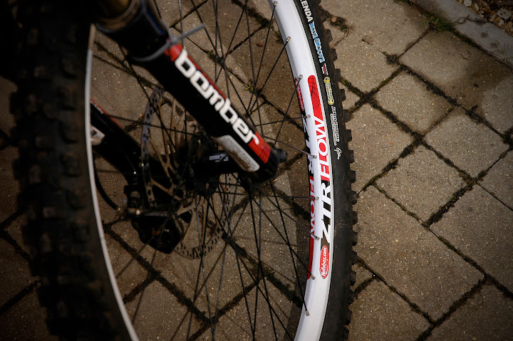

Literally this morning just taken the 717/XT wheels off my On One and replaced the rims with Flows for exactly the reason you describe - 2.35 tyres were wallowing about a bit too much for my liking. Couldn't really afford to fork out for Hope Hoops so just got the rims for £50 each and built them onto the existing hubs:

Those white rims look good with that fork, what fork you running? I've got a 120mm MX PRO with ETA and TAS works really well and I think the longer crown to axle length suits the geom of the frame and it was cheap! Going to have to get some experience building my own wheels, what jig do you use? Don't you wish they had put some fixings for a pump / bottle on the seat tube. I'm never going to put my seat that low down that it would catch. That is the only thing I would change on that frame.
Posted : 13/02/2010 9:41 pm
Er, I think they're MX Comps (100mm) from about 05/06.
No jig used. I tend to build wheels on my lap on the sofa then do the final bit of tightening/truing with the wheels on the bike, some zip ties on the seatstays/forks as guides. In fact you can see my zip ties in the second pic.
Yeah, bottle mounts on the seat tube would be handy. My saddle goes up and down a lot but not enough for bottle mounts to cause a problem I reckon.
