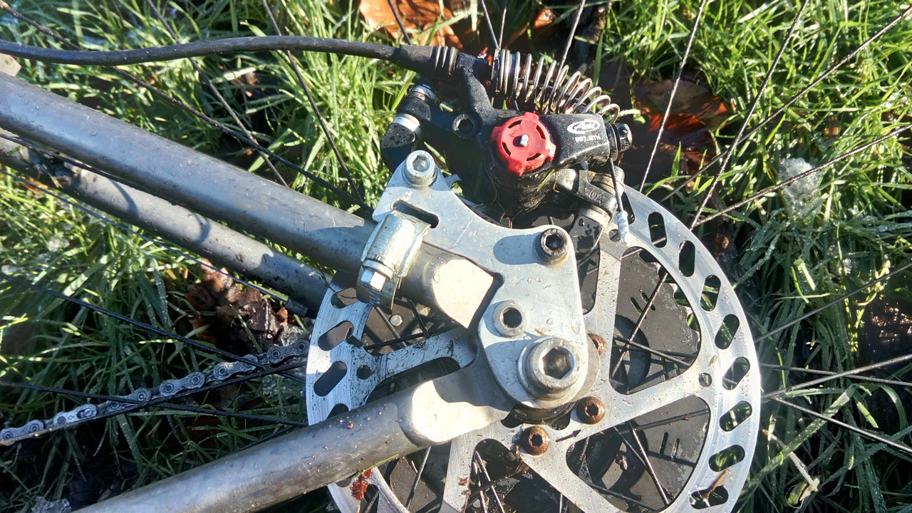

Posts: 3677
I made my own clamp on one. The hub bolt / qr clamps it in place, plus a second bolt and then jubilee clip just in case / stop it trying to rotate.
[url= https://i.postimg.cc/4NW2wkzH/DSC-0572.jp g" target="_blank">https://i.postimg.cc/4NW2wkzH/DSC-0572.jp g"/> [/img][/url]
Edit:postimage seems to be on the blink.
