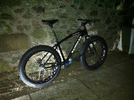

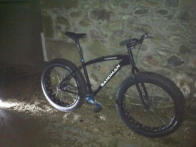

Been waiting on a 165mm rear hub - arrived just in time for the snow ! :s
just waiting on some precision tools to finish my custom axel 😀 - thats why its 900mm long atm - its 12mm in diameter as the hub is a sun ringle 165mm x 12mm and im gonna put 10mm flats on the axle , need some small files to tidy up the grinding to let the threads still be used!
not as heavy as i anticipated for sure !
hopefully encourage me to slow down and have fun 😀 compared to my race bikes its a weight 😉

my fork is a sandman 135 model ....
it is matched to an XT rear hub.
i was suppoed to have a cut and shut rear 165 xt but it went missing in royal snail
ringle ones better quality although for the intentions of this bike id have prefered C&C bearings ! - shaggy / aidan you guys have the experiance is there any grounding in my fears of cartridge and pawl units over c&c for freezing up and slowing down in the cold , will packing out the cart units with low temp grease be just as good as the same job in a C&C hub ?

Cartridge bearings are fine. We both used Hope SS hubs on the iditarod. I re-greased but I'm pretty sure Aidan just ran his as they came. Special grease really shouldn't be necessary in the UK. IME freehubs/pawls are much more likely to freeze up than bearings. Something like a hope or DT is good as you can dismantle it by hand and defrost it quite easily. Try that witha Shimano hub...
My forks are 135mm spaced as well.
XT rear seems fine. I have one built on to a "summer" 47mm rim.

Re weight: min is 27lb as pictured. I have a set of sc32s as well but haven't weighed it with them on yet.

In that picture it's a some trials rear rim and a xt hub, front wheel is a Flattop 80mm rim on a Echo hub. Rear wheel will soon be another Flattop and a modified DT hub.

weight is 35lbs
my build hasnt given any thoughts to weight - nor are the wheels light - the rims alone weigh more than my wheelset on my race bike .....think the wheels alone weigh in the region of 12lbs .....
if goldtec come up with their sandman hubs - i may go for a set of them on the rollin daryls/flattops if there that much lighter.
quite like my 165mm - 12mm hub into 165mm- 10mm frame axel - looks quite neat !
