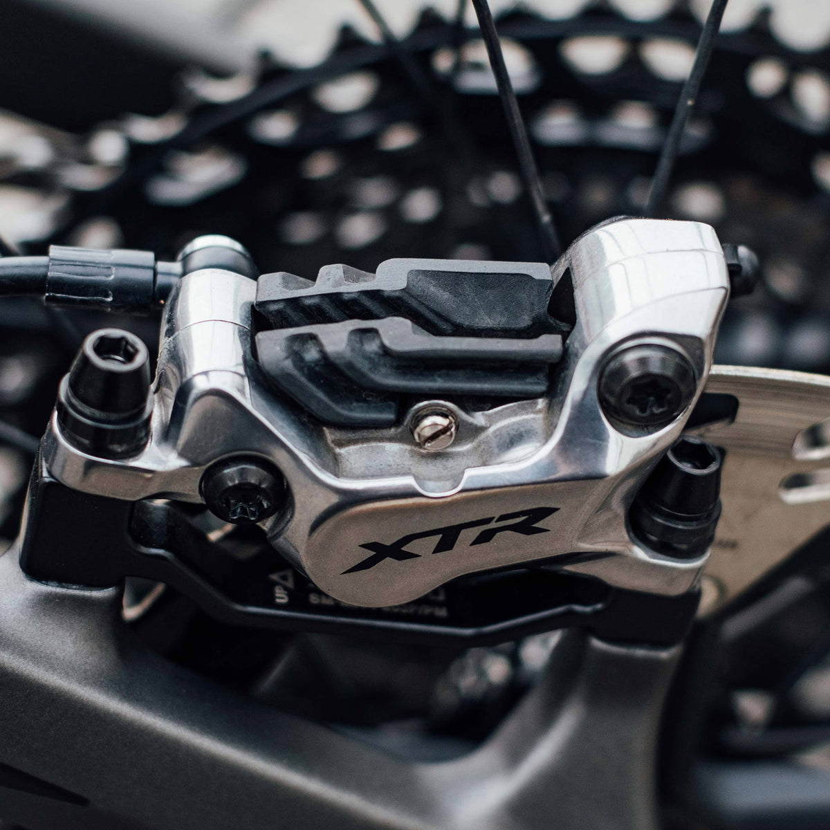

 pdw
Posts: 2206
More piston area for a given size of pad…
So more piston area for heat disposal
Except that the total piston area is essentially the same, as 4-pots use 4 smaller pistons.
4-pots give you larger pads with the force more evenly distributed for the same piston area.
Posted : 05/01/2021 12:36 pm
 pdw
Posts: 2206
But if we’re saying the only difference is between a 2pot caliper and a 4pot caliper (same levers, same fluid, same rotor, etc) the only difference will be in the effect on the pistons. The rest is identical. When there is a smaller piston area, the pressure acting on them and causing them to move is greater.
No. For a given force on a given master cylinder, the *pressure* in the caliper piston is exactly the same: it's the pressure of the hydraulic fluid.
If you use a smaller caliper piston, you'll get less force (but the piston will move further).
4-pots have smaller caliper pistons, but with more-or-less the same total area. Each piston exerts less force, but the total force acting on the pad is the same just more evenly distributed over a larger pad.
Posted : 05/01/2021 12:44 pm
Posts: 12673
No, unless you are talking about the master cylinder piston. The hydraulic pressure is determined by how hard you squeeze the lever, the mechanical leverage of the lever, and the size of the master cylinder piston. If the first two are constant, then a smaller master cylinder piston will give increased hydraulic pressure. If all those three are constant, then the hydraulic pressure will not change.
If you have the same hydraulic pressure, then a larger wheel cylinder will provide more force against the pads, so it will give more power. Two small pistons with the same total area as one large piston will provide the same force against the pad, but will let you run longer pads. The larger pad area should be less prone to overheating.
Posted : 05/01/2021 12:47 pm
