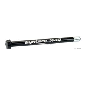

Now things are getting a little clearer, thanks for those suggestions. Yes honestly I am a bit confused about those stock hubs, my first time to encounter such as a beginner to AM setup. I dont have any original parts that makes things really though. I am reading about the Rockshox Maxle lite 12x142mm conversion kit, hoping that it would fit a standard Dtswiss X1600 wheelset. Any insights about this? Few of my friends were telling me to just sell the frame and give up, but the truth is I am just enjoying the difficulties getting those parts as I am beginning to learn more and more.
Posted : 06/02/2012 12:51 am
Posts: 8859
From your post, I'm assuming you haven't got the original axle, which would look like this
This is the axle on a cube stereo and is Syntace X-12 system, it just screws in by hand like a bolt into a nut, don't ask me why it doesn't just unscrew itself while in use, I don't know, but it doesn't. I'm reasonably convinced a maxle lite axle won't work (not sure tho), but note the thread on the end. Look at a maxle lite, it doesn't appear to have the thread. I think you'll need a DT Swiss X-12 axle or Syntace X-12 axle. The Syntace is cheaper. There is a thread about it a few months ago, someone managed to break their DT Swiss X-12 axle and were trying to replace it. I can link you to a site that sells the Syntace X-12 axle if you want.

Should I really stick with that X12 system? I have contacted Syntace and how to get this product to China where I am now. Now what if I will just get a hub compatible with Maxle Lite 142mm x 12? Would the frame be compatible with it?
Posted : 06/02/2012 4:56 pm
Posts: 8859
Any wheel hub that is 142mm X 12mm will fit.
Do you have an X-12 axle? Like in the picture above or like this
Posted : 06/02/2012 5:55 pm

Nope, I have none of the stock or original axle and wheelset parts. Syntace US had replied but did not confirm availablity yet of the X12 axle.
