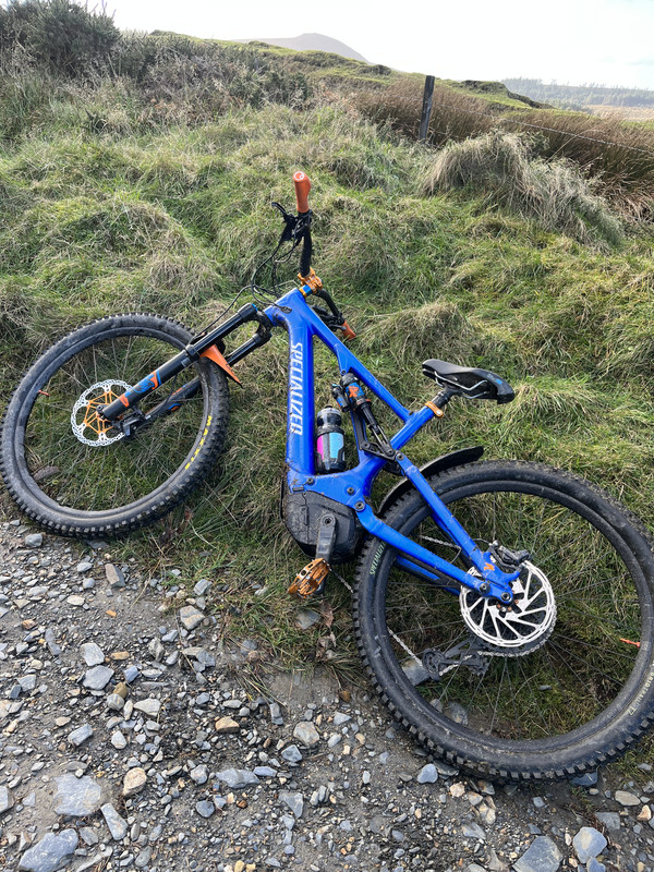

Hope this succeeds. Here before you: Cobalt/Orange Specialized Turbo Levo, utter tartery, I agree, but it’s my thing, so hwy-ho.
Front is a Hope 2.3mm 220mm rotor. Rear, same but 200mm (same width was stock SRAM, but slightly wider) just rubbed on the frame.
All I’m looking to do is replace the rear rotor with an orange one. Uberbike do them, but they’re 203mm not 200mm.
That’s my task. I know all about the “muppetry” etc involved in my decisions, but there it is.
[url= https://i.postimg.cc/DfDF9LdN/003359-DD-73-A8-43-DF-8-FD3-AA1604-BB8-D59.jp g" target="_blank">https://i.postimg.cc/DfDF9LdN/003359-DD-73-A8-43-DF-8-FD3-AA1604-BB8-D59.jp g"/> [/img][/url]

What is the rotor rubbing on? The frame or the brake caliper?

I’d just stick a 180 on I think. That rear rotor looks too big to me. Looks like there’s an adapter you can remove to take it down to 180 so job jobbed

Where is the thicker rotor rubbing? There are no crazy kinks in those tubes and there really should be a favourable amount of clearance between the face of the rotor and the frame. They get flexed, dinged and covered in mud and half a mm isn't a bumping lot to accommodate that.
Nice looking bike BTW, (also a tart but not orange or indeed rotors. At least you've not done the frame bolts or oil slick 😉)
I'm really not sure Hope make any 2.3 floating rotors. The 2.3 is a solid rotor, all the floaters are 1.8 except the vented which is 3mm.
Where is the rear floater rubbing? Is it the rivets on the brake mounts/adaptor?

It’s been said already, but the Hope floating rotors aren’t 2.3mm thick, they’re 1.8mm. You can only get 2.3mm thick in the standard 1 piece.

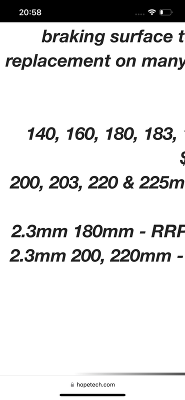

This is taken from the hopetech page and the advert for the discs I bought:
[url= https://i.postimg.cc/0ytn8T95/79-E4-A6-D2-1-EB8-43-D9-87-A7-6-AC1-E7-F985-E0.pn g" target="_blank">https://i.postimg.cc/0ytn8T95/79-E4-A6-D2-1-EB8-43-D9-87-A7-6-AC1-E7-F985-E0.pn g"/> [/img][/url]

The 2.3mm is for the heavy duty rotor and it only comes in silver - https://www.hopetech.com/products/brakes/discs-accessories/heavy-duty-23mm-rotor/
Or the standard and floating disc appears to have the option and the floating option does colour in a 200mm option -
https://www.hopetech.com/products/brakes/discs-accessories/standard-and-floating-rotors/
So looks like you call Hope and order up a 200mm 2.3mm thick floating rotor in orange.
the 2.3mm rotors are £5 cheaper in all sizes. I’d assume it’s not a floating rotor. Not the easiest to understand site
looks like, yes. But they don’t make 2.3 in floating. Also, they don’t do direct sales, but that’s by the by. Maybe bad description on website but I have an email from Hannah in sales stating as much if anyone needs to see it.
